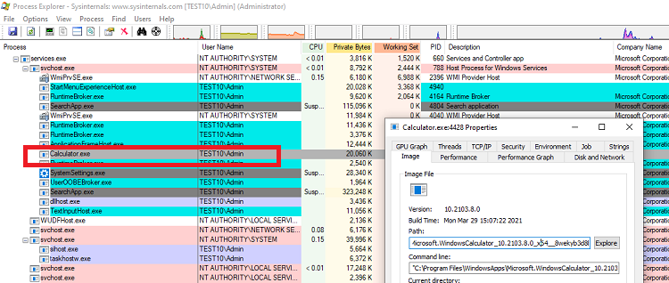

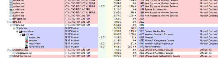

    I will speculate that it has something to do with UWP applications. When I launch C:\Windows\System32\calc.exe what ends up running is C:\Program Files\WindowsApps\Microsoft.WindowsCalculator_10.2103.8.0_x64__8wekyb3d8bbwe\Calculator.exe.
    But traditional Windows apps like notepad and your PdftoPrinter run as child processes of sshd/cmd. Since I have the SSHD process running as a service, I do not have any way to interact with the GUI.

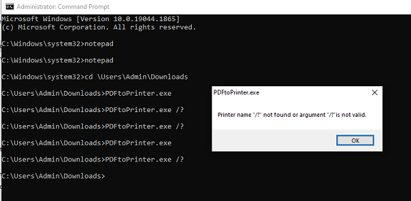

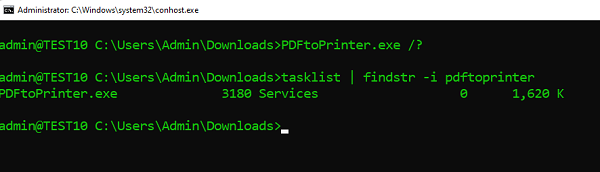

    You can launch a GUI over SSH but you can't interact with it. For that program, you will have to enter a valid command sequence, because you will have no way to know if it works or not other than to see that the program is still running.
    From a desktop command prompt....
    In an ssh session....
    if you need to run the program over SSH, then it should be a full command line program that only outputs to stdout and stderr. Message boxes are no good.
