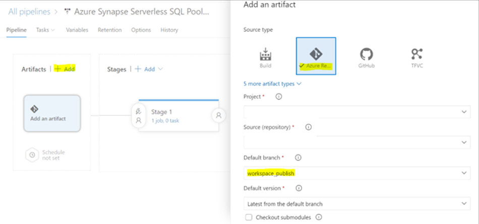

    Azure Synapse Serverless SQL Continuous Deployment/ Release Pipeline:

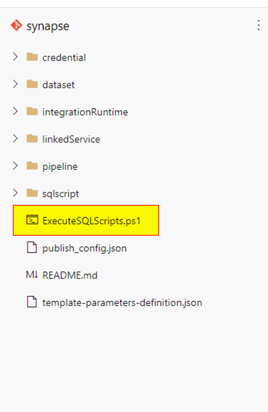

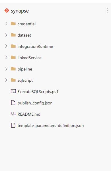

    a) After the Synapse Workspace GIT Configuration, verify the repository folder structure as shown-
    b) Add the PowerShell Script under the synapse folder as shown-
    c) Create a New Release Pipeline with an empty job.

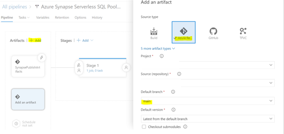

    d) Link the following artifacts to the release pipeline:
    1. SynapsePublishArtifacts
    2.SynapseSQLObjectsArtifacts

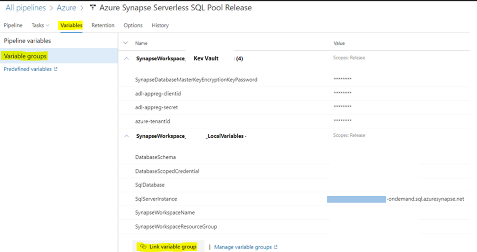

    e) Create and link the Variable Groups to the Release Pipeline with appropriate values for the variables– Resource Group, Synapse Workspace, SQL Server Instance, SQL Database, Database Schema, Database Scoped Credential, Master Key Encryption Password, ClientID, TenantID, and Client Secret.

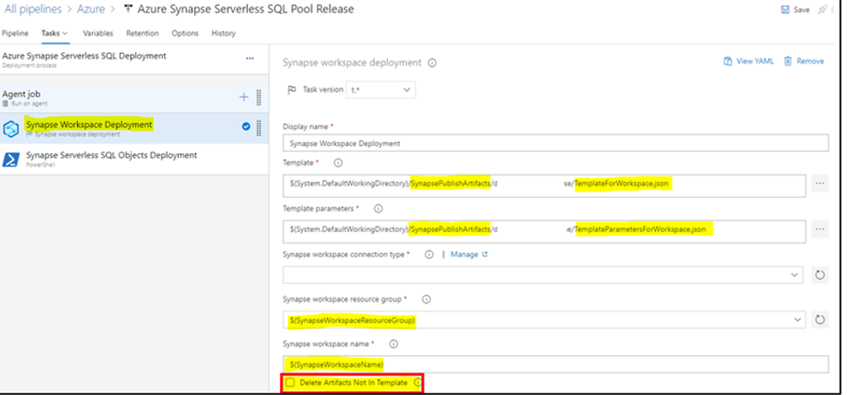

    F) In the Release Pipeline Stages, add the Synapse Workspace Deployment task to deploy the Synapse Workspace.
    Note: Pay attention to the “Delete Artifacts Not in Template”- if enabled this will delete any artifacts from the previous releases not present in the current release publish artifacts.

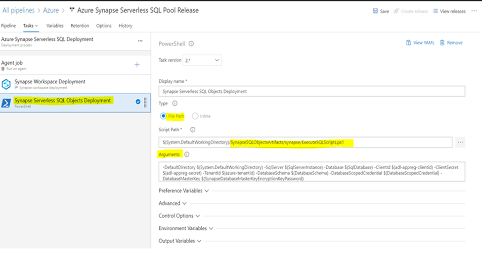

    g) Now add the PowerShell task to deploy the Synapse Serverless SQL Objects to the Synapse Workspace.

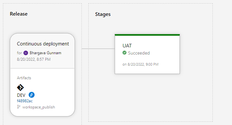

    h) Create the pipeline release to verify the Synapse Serverless SQL Deployment.
