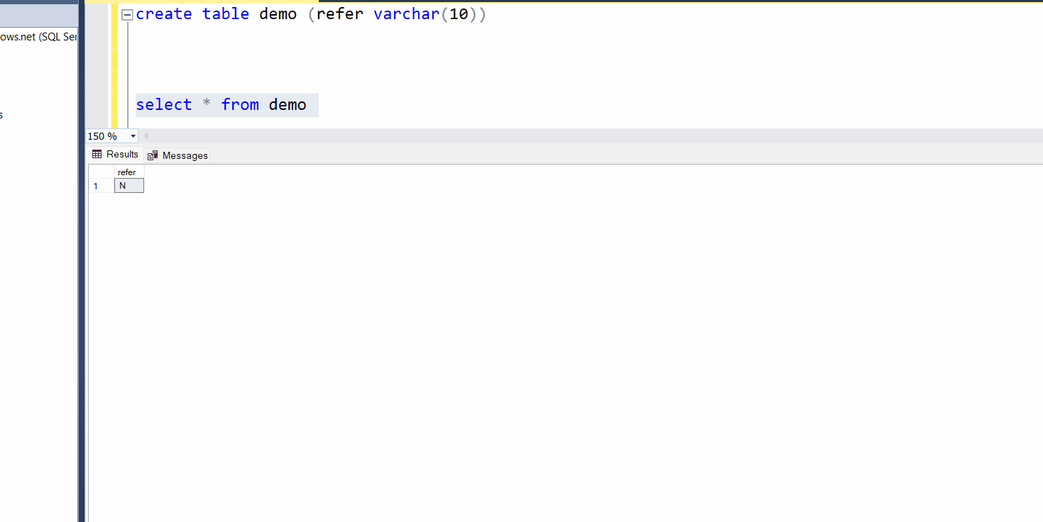

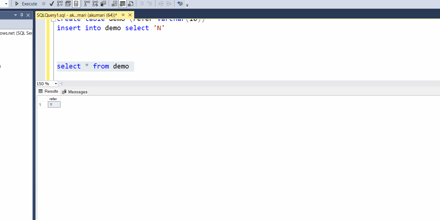

    From the above query, what I understand is that you are trying to compare the data present in refer column of demo table. Once the value equals Y , then set the variable untilflag to True. Kindly let me know if my understanding is incorrect.
    I tried to repro your requirement and didn't find any issue.
    Case 1: When the 'status' value is Y , it means that the if condition @equals(activity('Lookup1').output.firstRow.status,'Y') would return true which would eventually change the variable value to True. Once variable becomes True , it means untill block would result in True @bool(variables('untilflag')) as it's checking that until the variable returns true keep on executing the activities inside. The execution will end after the first loop.
    Case 2: When the 'status' value is N , it will keep on running the activities inside until block until the status becomes Y . Once @activity('Lookup1').output.firstRow.status returns Y , the loop will break.

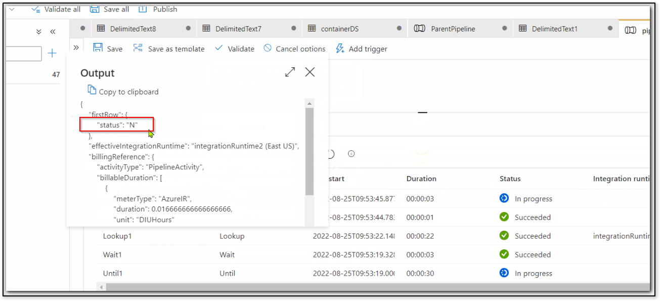

  2. KranthiPakala-MSFT 46,642 Reputation points Microsoft Employee Moderator
    2022-08-25T21:26:19.977+00:00

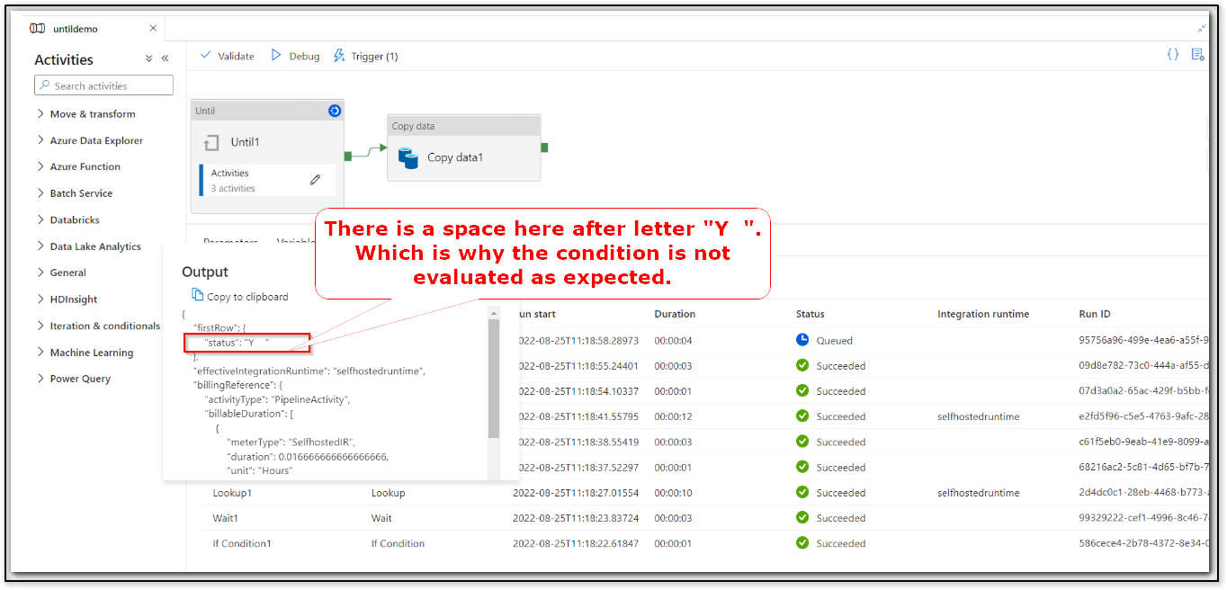

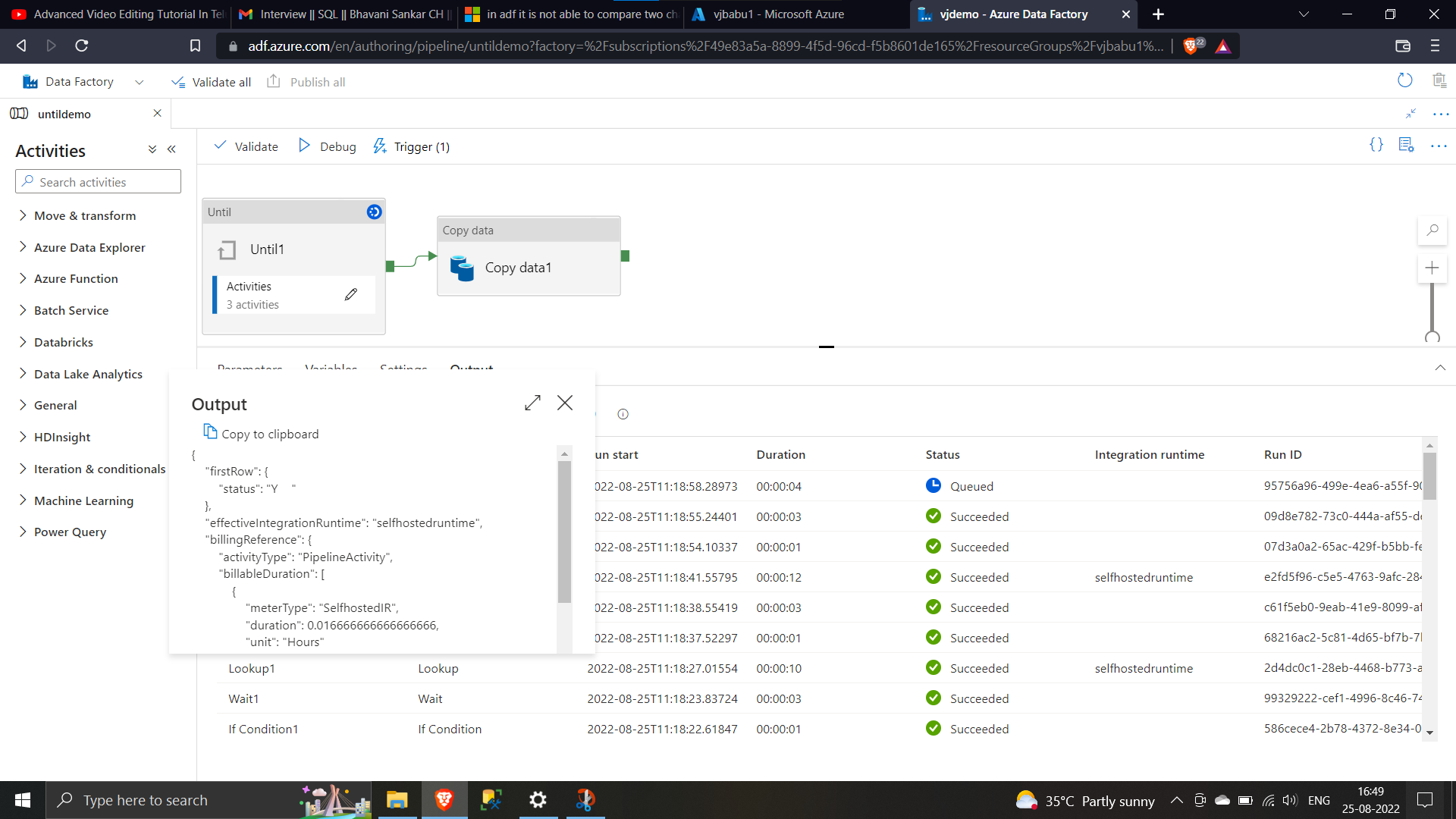

    Hello @sankar challa ,
    Thanks for sharing additional screenshot of your Lookup activity response JSON payload. One thing I have noticed from Lookup response JSON payload, there is a space in the value for the column status (status:"Y ")
    Below observation is from the screenshot you have shared:
    Below screenshot from @AnnuKumari-MSFT GIF (where the lookup field doesn't contain any space after letter Y or N which is why Anu condition is evaluating as expected).
    Since there is a space which is causing this problem, there are two workarounds to overcome it.
    Workaround 1: Either make sure source data in your table/column doesn't have leading or trailing spaces after "Y" / "N".
    Workaround 2: Or you can even Trim the leading/trailing spacing using Trim() function to just consider the "Y" or "N" and truncate the extra spaces. Sample dynamic expression would look like @equals(trim(activity('Lookup1').output.firstRow.status), 'Y') in your If condition activity
    Hope this info helps to resolve your issue. Do let us know how it goes.

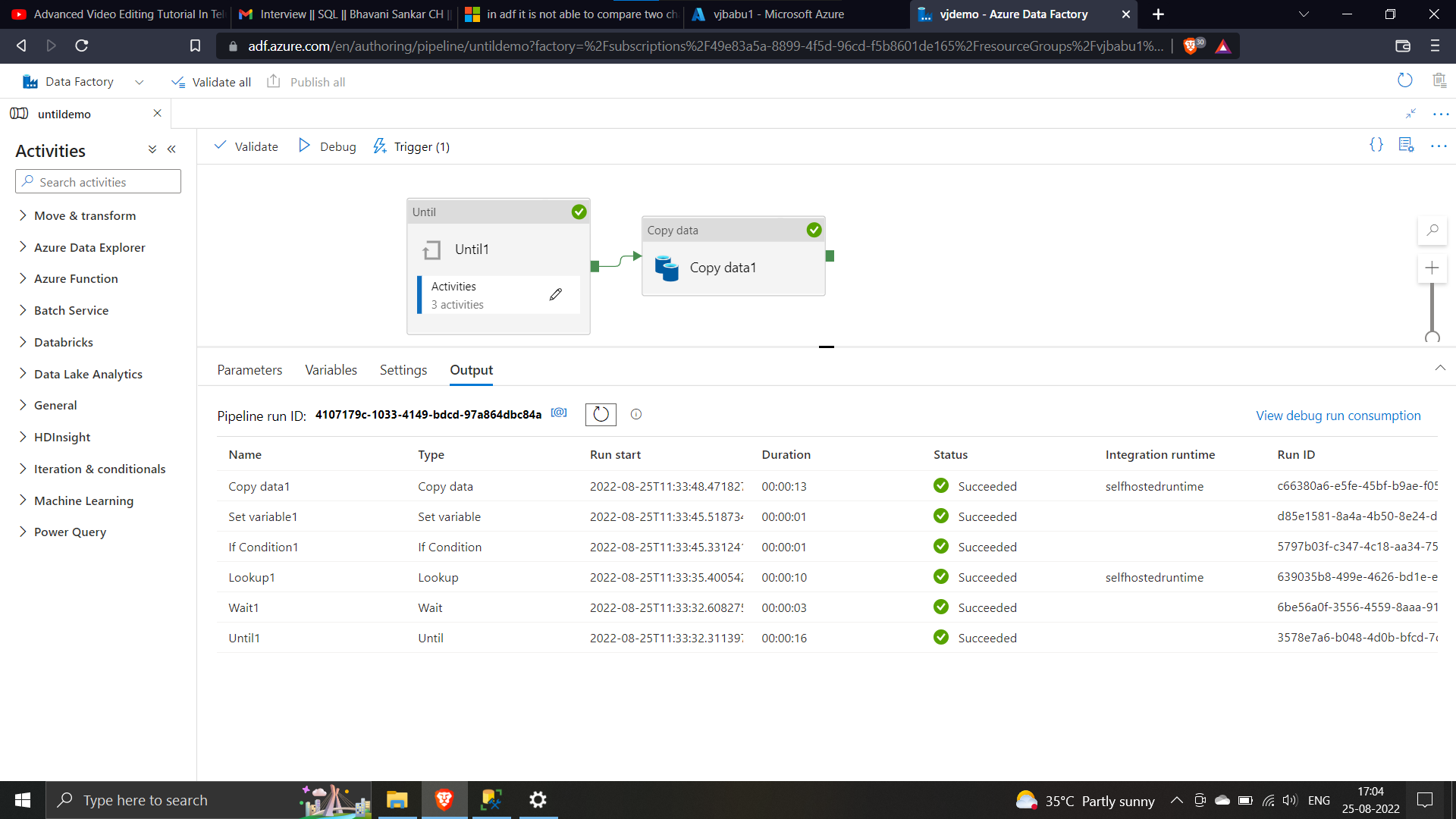

  3. sankar challa 1 Reputation point
    2022-08-25T11:36:01.007+00:00
    I tried in other way by changing the column refer(char data type) to column ID(int data type) from table demo . Hence the column changed i will get the integer value of 1 in the place of 'Y', i compared it ....it looks something like this @equals(activity('Lookup1').output.firstRow.status,'1') with this i get the desired result.
