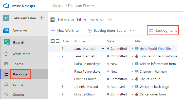

With backlogs, you can plan your project by adding user stories or requirements to your product backlog. With your plan in place, you can start driving code development efforts.
If you're a project administrator, see Configure and customize Azure Boards, which shows you how to define area and iteration paths and customize your work item types. When you create a project or add a team, Azure Boards automatically creates a backlog. Each team has access to their own product, portfolio, and sprint backlogs. For more information, see About teams and Agile tools.
An Azure Boards backlog is a prioritized list of work items that guides your developments team's effort. A backlog helps manage project scope and facilitates effective communication and collaboration through the software development lifecycle.
Use backlogs to do the following tasks:
Note
For more information, see Backlogs, boards, and plans. In case you don't see the desired work items on your backlog or board, see Set up your backlogs and boards.
Backlogs present work items as lists. A product backlog represents your project plan, the roadmap for what your team plans to deliver. It also provides a repository of all the information need to track and share with your team.

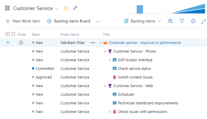

When you have many initiatives your teams are working on, you might want to group the work according to these initiatives. By defining features and epics, you can group your work into a three-tiered hierarchy consisting of epics, features, and backlog items.
For example, here the Customer Service team organized several backlog items under two features and one epic.

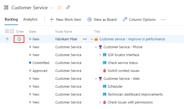

When you have several teams, your hierarchical views can show items that belong to other teams.
Your team's product backlog lists only those items whose area path matches items assigned to your team. If you show parents, you see the parent epic of the features and backlog items, even if another team owns the epic or feature.
Other team-owned items appear with an information icon
Tip
Add the Node Name field as a column to identify the area path/team associated with the work items.

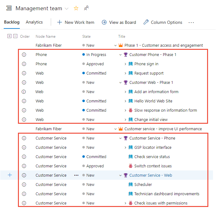

Here's another example that shows the Epics backlog for the Management team. Drilling down, you can see all the backlog items and features, even though they belong to one of three different teams: Customer Service, Phone, and Web.
From these views, you can reparent items that you own and items other teams own. You can't reorder items that another team owns.
This organization enables management teams to focus on high-level features and epics, and development teams to focus on just the backlog items they're responsible to deliver. For example, you can create a team structure similar to this one with two management and three development teams. For more information, see Create or add a team.

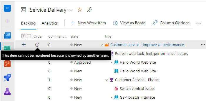

All backlogs and boards support dragging to reorder and reparent work items. Updates made to one team's backlogs and boards are reflected in other team backlogs and boards that share the same area path. You might need to refresh the page to view the changes.
You can only use dragging to reorder or reparent work items assigned to area paths selected for your team. When the Parents view option is enabled, work items might appear on your backlog that your team doesn't own. Anything that appears with the
information icon can't be reordered or reparented because another team owns it.
