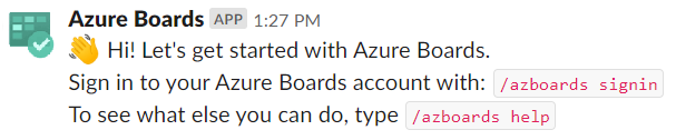

To install the Azure Boards app to your Slack workspace, open a web browser, sign into Slack, and open the Azure Boards app.
Once added, you'll see a welcome message from the app as shown in the following image.
Use the
/azboards
Slack handle to interact with the app. A list of commands is provided later in this article, Command reference.

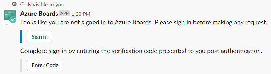

Once the app has been installed in your Slack workspace, connect and authenticate yourself to Azure Boards.
After signing in, use the following slash command inside a Slack channel to link to the Azure Boards project that you specify with the URL:

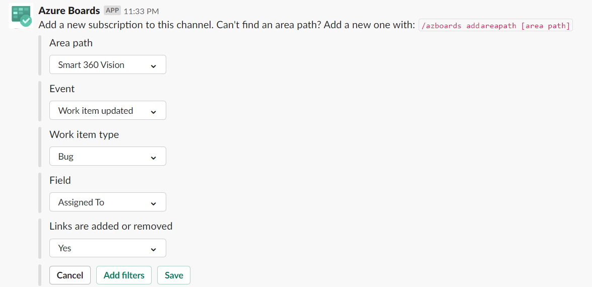

You can create subscriptions to monitor work items at any time using the /azboards subscriptions
command. You have an option of setting up
subscriptions just after linking a project.
Select area path you want, the event that you're interested in, and use the associated filters to customize your Slack channel. To easily set up subscriptions, your recently accessed area paths are shown in the area path dropdown.
In case your team's area path doesn't appear in the Area path dropdown menu, follow the instructions mentioned in the next section, Add area paths. Area paths added using the
/azboards addAreapath
command and area paths for which subscriptions are created in the Slack channel always appear in the Area path dropdown along with recently accessed area paths.

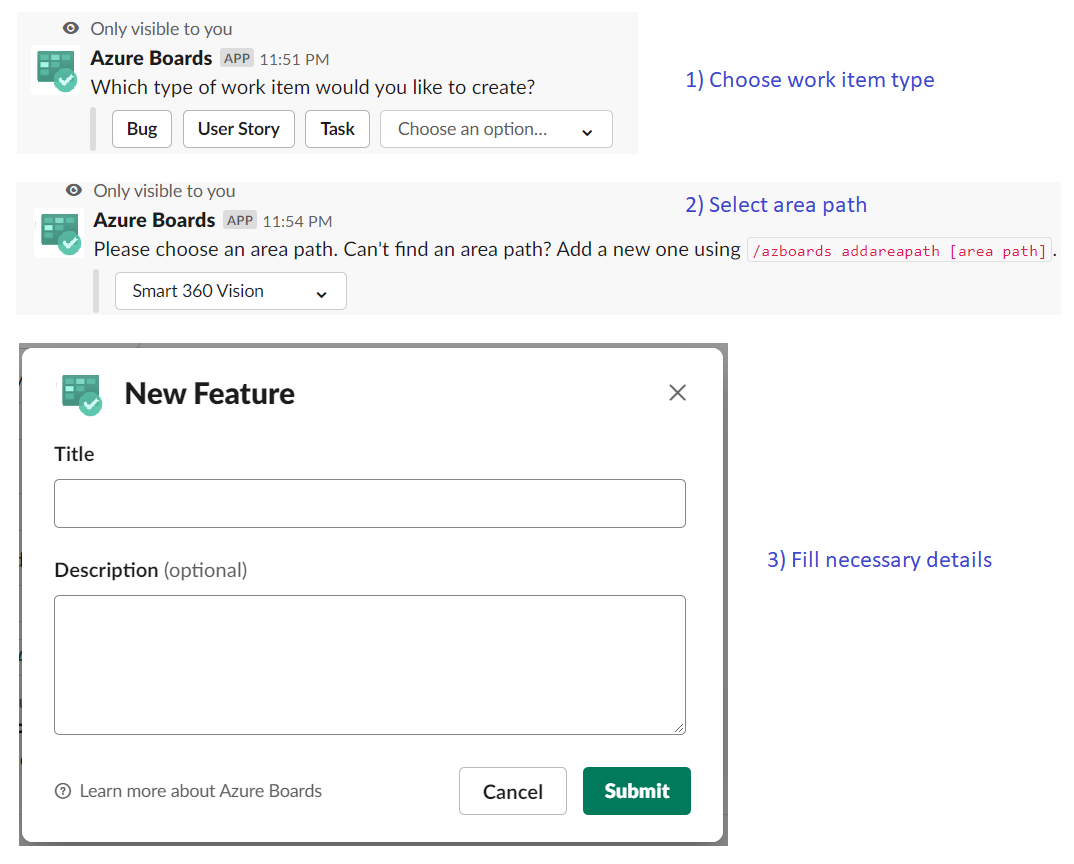

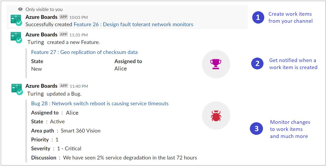

Create a work item with a command
- With the Azure Boards app, you can create work items from your channel. The app supports custom work items as well.
To create a work item, use
/azboards create
You can create work items directly from a command by passing work item type and title as parameters. Work items will be created only if they don't have any fields to be mandatorily filled.
/azboards create [work item type] [work item title]
For example:
/azboards create 'user story' Push cloud monitoring alerts to mobile devices

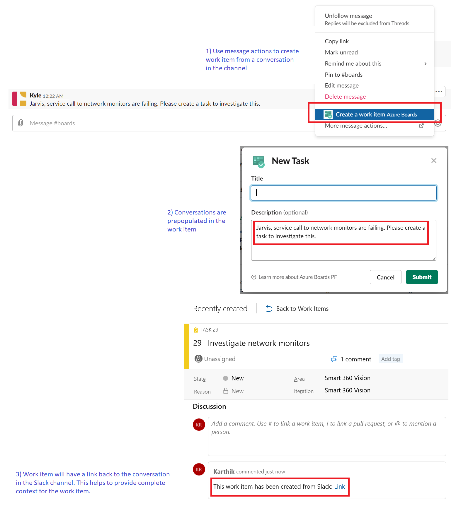

Create a work item from message actions
Often, discussions in a channel call for creation of work items. You can use message actions to create a work item. The selected message is prefilled in the description section of the work item. A link back to the conversation in the channel is stored in the Discussion section of the newly created work item, giving users access to the discussion that led to the creation of the work item.
To create work items using message actions

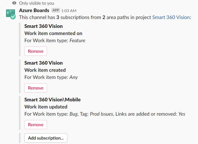

Manage Azure Boards subscriptions
To view, add and remove subscriptions for a channel, use the
command:/azboards subscriptions
This command lists all the current subscriptions for the channel and allows you to add new subscriptions and remove existing ones. As part of adding subscriptions, you can also customize what you get notified on by using various filters.

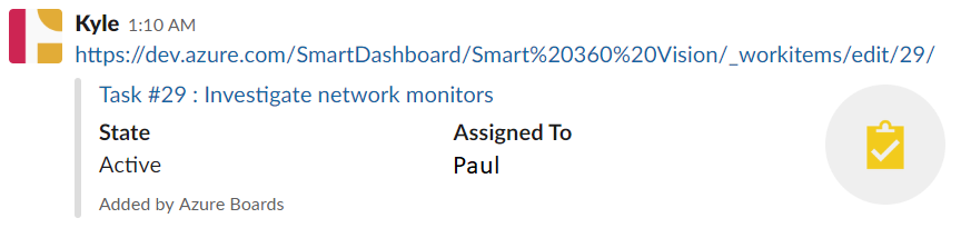

Previews of work item URLs
To support collaboration around work items discussed within a channel, a preview of work items referenced in the channel is displayed. When a user pastes the work item URL, a preview is shown similar to the following image. This preview helps to keep work-item-related conversations relevant and correct.
For this feature to work, users have to be signed-in. Once they're signed in, this feature will work for all channels in a workspace.

/azboards signin | Sign in to your Azure Boards organization |
/azboards signout | Sign out from your Azure Boards organization |

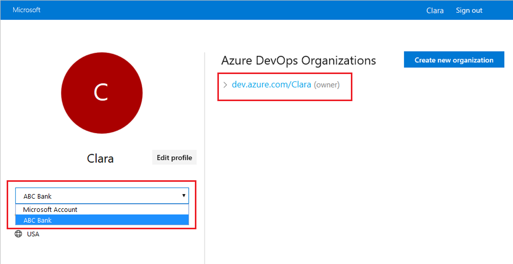

Open an In private or incognito browser window and navigate to https://aex.dev.azure.com/me
and sign in. In the dropdown under the profile
icon to the left, select the directory that contains the organization containing the project that you want to link.
In the same browser, start a new tab, navigate to https://slack.com
, and sign in to your work space (use web client). Run the /azboards signout
command followed by the /azboards signin
command.
Select the Sign in
button and you'll be redirected to a consent page like the one in the following example. Ensure that the directory shown beside the email is same as what was chosen in the previous step. Accept and complete the sign-in process.
