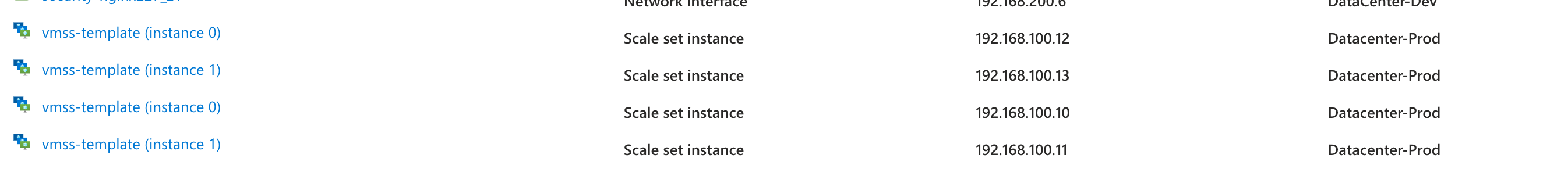

ramiro [ ~ ]$ az network lb inbound-nat-rule delete -g RG-datacenter --lb-name lb-Ciber-Security-Prod-145232 -n natPoolTemplate22.0
(AddingOrUpdatingNatRulesWhenNatPoolIsPresentOnLoadbalancerIsNotSupported) Adding or updating NAT Rules when NAT pool is present on loadbalancer /subscriptions/1990d9fb-bf64-4e95-a033-ada573e7a7bb/resourceGroups/RG-datacenter/providers/Microsoft.Network/loadBalancers/lb-Ciber-Security-Prod-145232 is not supported. To modify the load balancer, pass in all NAT rules unchanged or remove the LoadBalancerInboundNatRules property from your PUT request.
Code: AddingOrUpdatingNatRulesWhenNatPoolIsPresentOnLoadbalancerIsNotSupported
Message: Adding or updating NAT Rules when NAT pool is present on loadbalancer /subscriptions/1990d9fb-bf64-4e95-a033-ada573e7a7bb/resourceGroups/RG-datacenter/providers/Microsoft.Network/loadBalancers/lb-Ciber-Security-Prod-145232 is not supported. To modify the load balancer, pass in all NAT rules unchanged or remove the LoadBalancerInboundNatRules property from your PUT request.

    Entiendo que no puede eliminar la regla NAT de entrada y la instancia de VMSS también.
    Para fines de prueba adicionales, intente probar con los comandos a continuación y hágamelo saber el resultado.
    Antes de eliminar la regla NAT de entrada, consulte el siguiente documento para obtener más información: https://learn.microsoft.com/en-us/azure/load-balancer/load-balancer-nat-pool-migration?tabs=azure-cli#virtual-machine-scale-set
    az network lb inbound-nat-pool delete  -g MyResourceGroup --lb-name MyLoadBalancer -n MyNatPool
    az vmss update -g MyResourceGroup -n MyVMScaleSet --remove virtualMachineProfile.networkProfile.networkInterfaceConfigurations[0].ipConfigurations[0].loadBalancerInboundNatPools
    az vmss update-instances --instance-ids '*' --resource-group MyResourceGroup --name MyVMScaleSet
