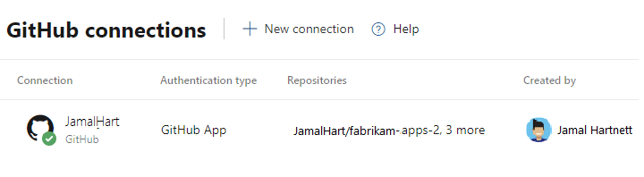

After making your selections, select Save.
Confirm the connection
Review the GitHub page that displays and then choose Approve, Install, & Authorize.
Provide your GitHub credentials to confirm.
When you're done, you should see the new connection with the selected repositories listed.

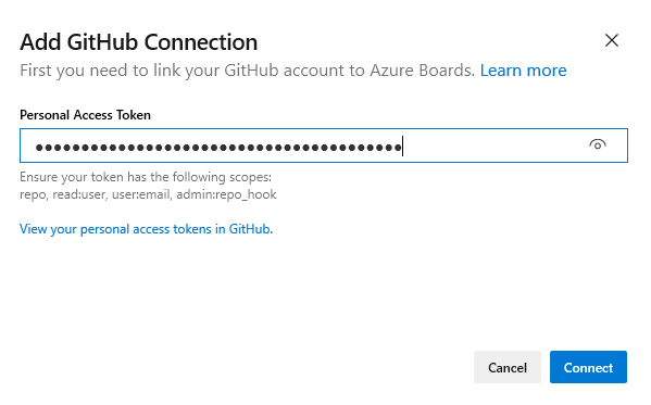

Add a GitHub connection using PAT
Important
We recommend the more secure Microsoft Entra tokens over higher-risk personal access tokens. Learn more about our efforts to reduce PAT usage. Review our authentication guidance to choose the right authentication mechanism for your needs.
We recommend using your GitHub account credentials to connect to your GitHub repository.
Tip
When you create your GitHub PAT, make sure that you include these scopes: repo, read:user, user:email, admin:repo_hook.
Choose Personal Access Token.
To create a GitHub PAT, go to GitHub Developer Settings > Personal access tokens.
Enter the PAT and select Connect.
Select the repositories you want to connect to the project by following the procedures outlined in Choose the repositories earlier in this article.
