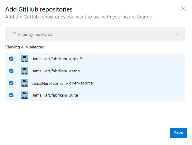

Add GitHub repositories
After you authenticate, select the repositories to connect.
  1. The Add GitHub Repositories dialog displays and preselects all repositories where you're an administrator in the selected organization. Clear any repositories you don't want to connect.
    Screenshot showing GitHub repos.
    Tip
    Connect each GitHub repo to projects in a single Azure DevOps organization to avoid unexpected AB# mention linking. For more information, see Resolve connection issues.
    If all repositories are already connected to the current or another organization, the following message appears:
    Screenshot of message where no more repositories exist to connect.
  2. Select Save.
