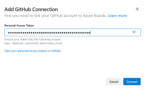

Add a GitHub connection using PAT
We recommend that you use your GitHub account credentials to connect to your GitHub repository. However, if you need to use a PAT, do so by following these procedures.
Tip
When you create your GitHub PAT, make sure that you include these scopes: repo, read:user, user:email, admin:repo_hook.
  1. Choose Personal Access Token.
    Screenshot of New GitHub connection dialog, choosing Personal Access Token.
    To create a GitHub PAT, go to GitHub Developer Settings > Personal access tokens.
  2. Enter the PAT and choose Connect.
    Screenshot showing entered PAT.
