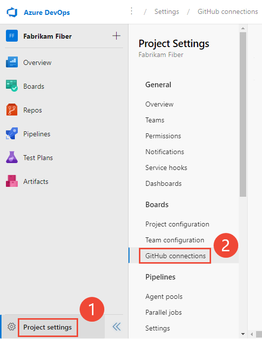

  1. Sign in to your project (https://dev.azure.com/{Your_Organization/Your_Project}).
  2. Select Project settings > GitHub connections.
    Screenshot of open Project Settings>GitHub connections.

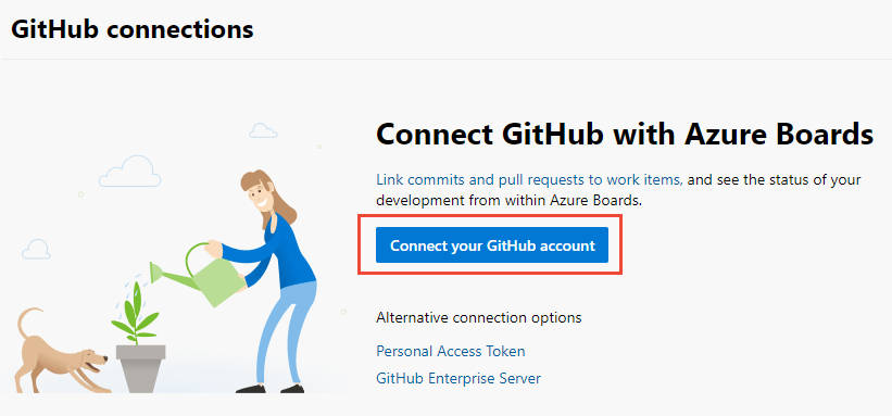

  3. For a first-time connection, select Connect your GitHub account to authenticate with your GitHub credentials.
    Screenshot of first time connecting with GitHub credentials.
    For subsequent connections, select New connection and choose your authentication method.

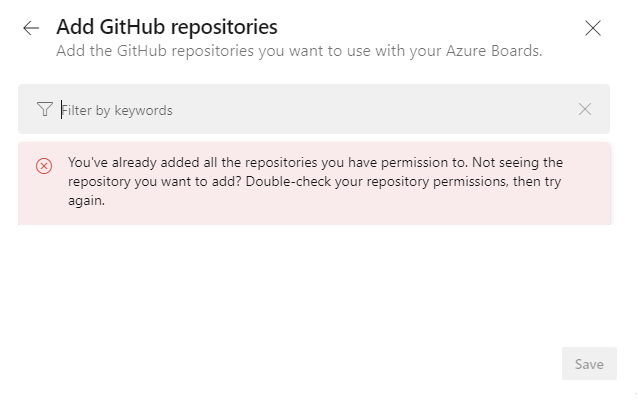

    If all repositories for an organization are already connected, the following message appears:
    Screenshot of message where no more repositories exist to connect.

    If all repositories are already connected to the current or another organization, the following message appears:

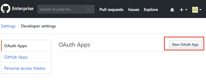

  1. Sign in to the web portal for your GitHub Enterprise Server.
    Screenshot of sign in for GitHub Enterprise server.
  2. Open Settings > Developer settings > Oauth Apps > New OAuth App.
    Screenshot showing sequence for New OAuth App.

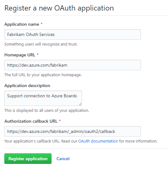

  3. Enter registration information.
    • Homepage URL — Your organization URL.
    • Authorization callback URL — Use the pattern {Organization URL}/_admin/oauth2/callback. For example: https://dev.azure.com/fabrikam/_admin/oauth2/callback
    Screenshot showing app to register.

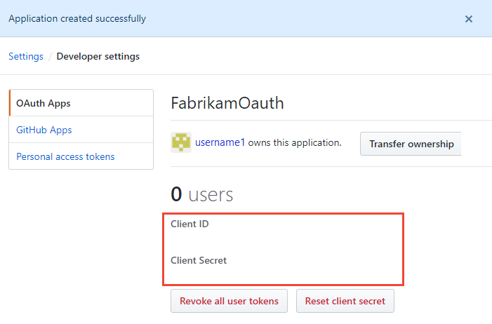

  5. Copy the Client ID and Client Secret that appear for your registered OAuth application.
    Screenshot of Client ID and Client Secret for the registered OAuth application.

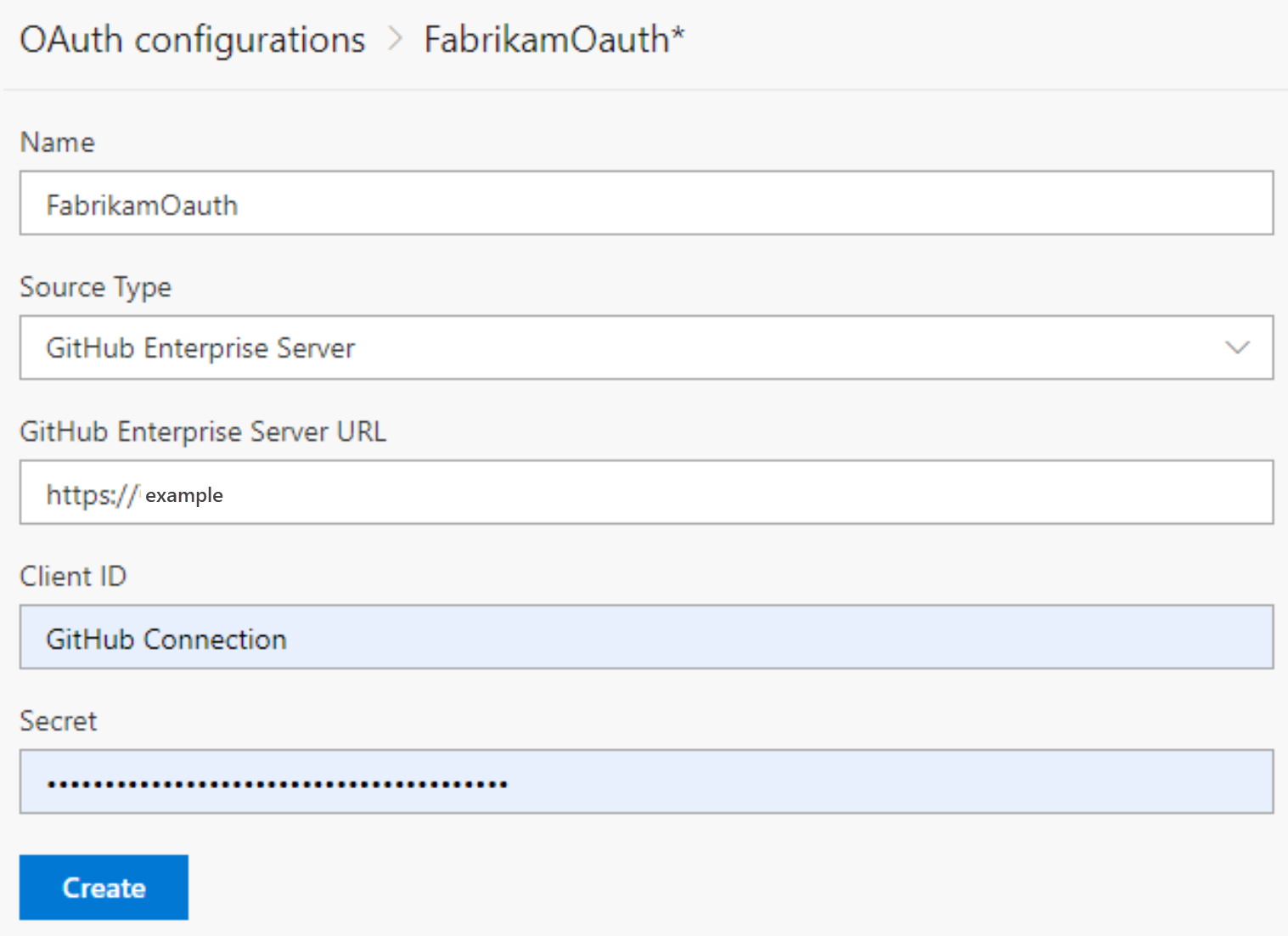

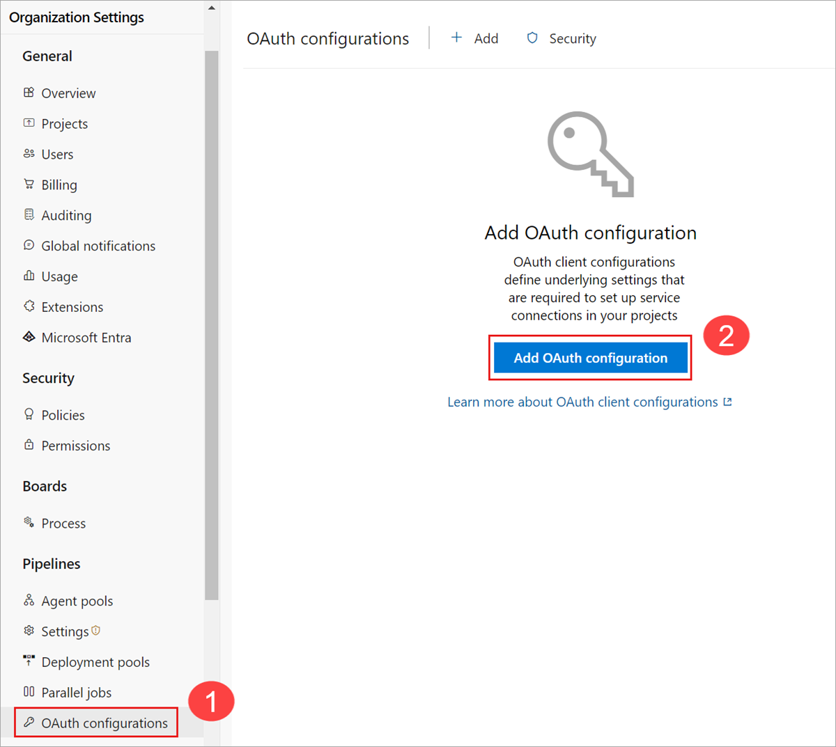

Register your OAuth configuration in Azure DevOps Services
  1. Sign in to the web portal for Azure DevOps Services.
  2. Select Organization settings > Oauth configurations > Add Oauth configuration.
    Screenshot of Open Organization Settings, OAuth configurations.
  3. Enter your information and select Create.
    OAuth configurations dialog.

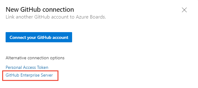

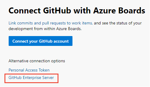

  1. Select Project settings > GitHub connections > GitHub Enterprise Server for a first-time connection.
    First connection, GitHub Enterprise Server option.
    For subsequent connections, select GitHub Enterprise Server from the New GitHub connection dialog.
    Screenshot of New GitHub connection dialog, choose GitHub Enterprise Server.

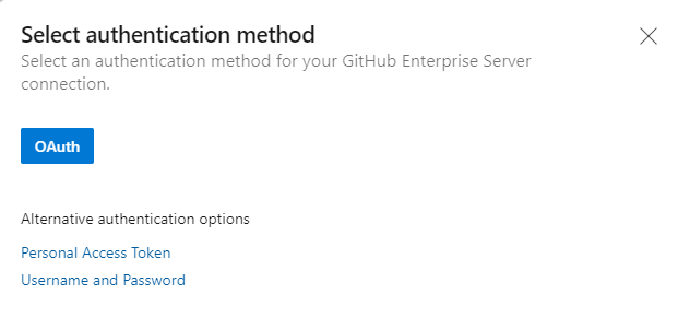

  2. Select the authentication method.
    Screenshot showing authentication method dialog.

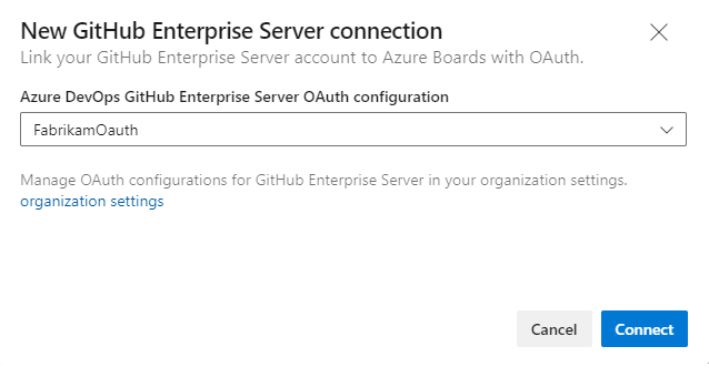

    Connect with OAuth — Select the OAuth configuration you registered in Register your OAuth configuration, then select Connect.
    Screenshot of New GitHub Enterprise connection, OAuth connection dialog.

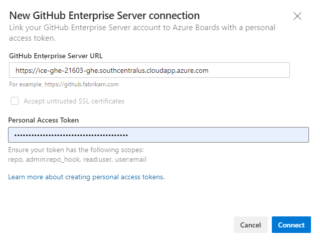

    Connect with a Personal Access Token — Enter your GitHub Enterprise Server URL and PAT, then select Connect.

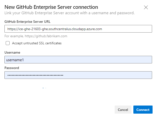

    Connect with GitHub credentials — Enter your GitHub Enterprise Server URL and administrator credentials, then select Connect.
    Screenshot of New GitHub Enterprise connection screen, User Name connection dialog.

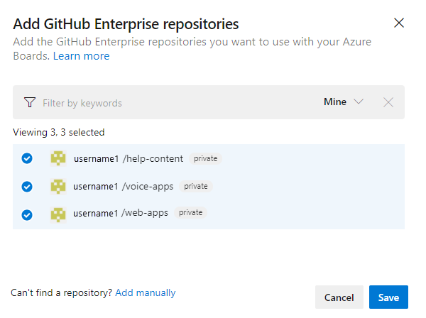

  3. The dialog lists all repositories where you have administration rights. Toggle between Mine and All to find additional repositories, select the ones to add, and then select Save.
    Screenshot of repositories listed.

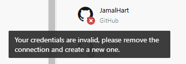

Resolve access issues
When the Azure Boards connection to GitHub loses access, a red-X alert appears in the UI. Hover over the alert to confirm the credentials are no longer valid. Remove the connection and create a new one.
Screenshot of failed connection.
