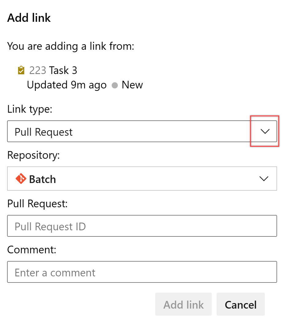

  1. Open your work item and go to the Development area.
  2. Select Add link. From each dropdown menu, select your link type, GitHub repository, and GitHub pull request. You can search and drill down within the repository to find and select a specific pull request or commit, without needing to copy and paste a URL.
  3. Select Add link.
    Screenshot showing five-step sequence for adding a pull request link to work item.
    Azure Boards checks to ensure that you entered a valid link. The linked-to GitHub repository must be connected to the Azure Boards project or the validation fails.
