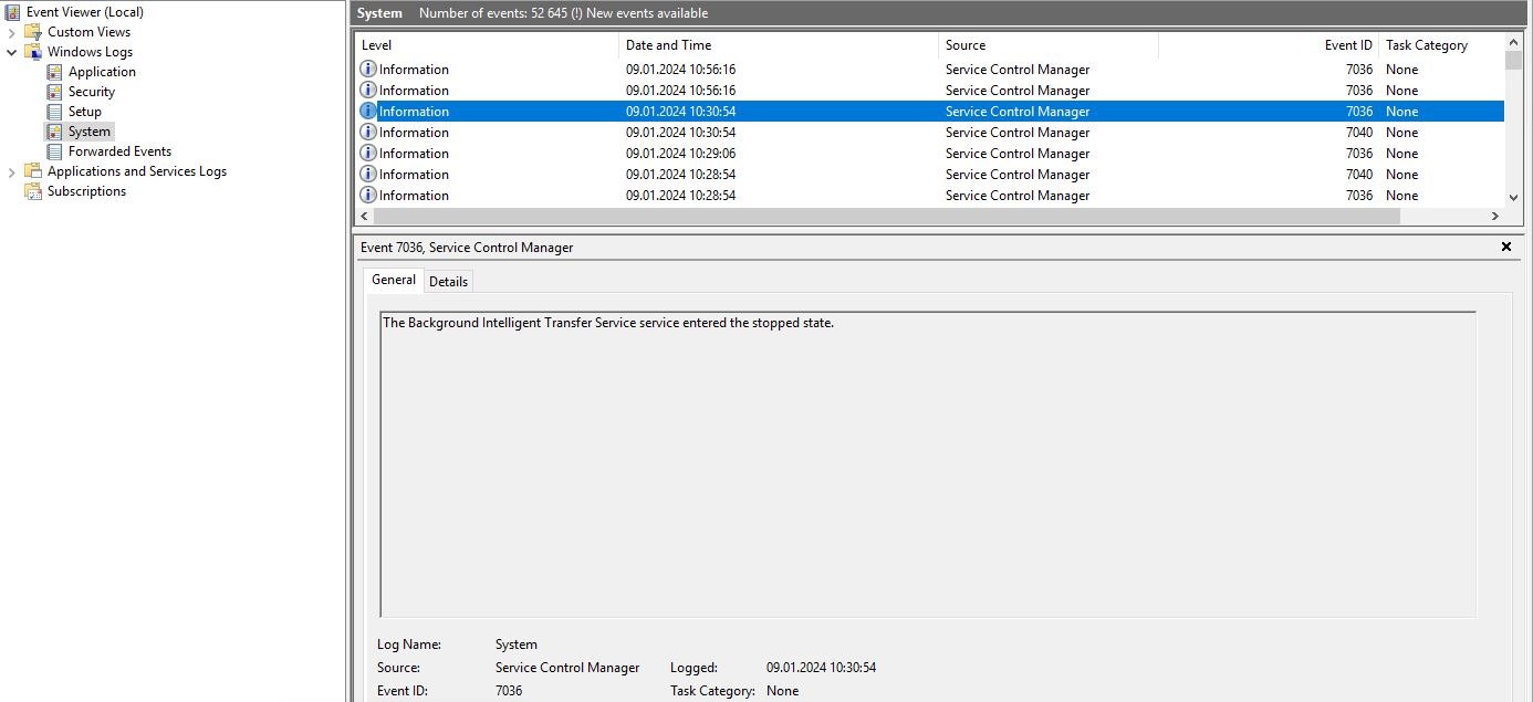

  4. Anonimowe
    2024-01-09T10:13:04+00:00
    I checked Event Viewer.
    In Windows Logs/Applications there is no any logs from BITS.
    In Windows/System there is only information about start and stop:
    ![Obraz](https://filestore.community.support.microsoft.com/api/images/76614cce-3f00-46d6-bf3e-f61e158ed2a4?upload=true&fud_access=wJJIheezUklbAN2ppeDns8cDNpYs3nCYjgitr%2BfFBh2dqlqMuW7np3F6Utp%2FKMltnRRYFtVjOMO5tpbpW9UyRAwvLeec5emAPixgq9ta07Dgnp2aq5eJbnfd%2FU3qhn548u0ou0NUcf9JKCYhSwJ9TKcyPW0HACdFTFyAsgIHK1cl6kmKRNuzMRLMfTrZadQlR%2Bg2rfno1i1RYLyT4H8v3PSV8jbexOKVPq7%2BWdDXRhG%2FLiuQL6RA1VD94UJ7Pyz6EgRuTdODtpNCO9lFPXShrnKqAcOlAmG4qoOmVUaUSb92JESGfw1GHWbBc3VzMiz1mlcutM3QBcBCt%2BuwXOOvbCks4XdcEZD8JEw%2BvQSZenE9pogQT0lqlqR8c0NoIA3zE7z0ZXPAlpikIHLz9MGCEVPvIdJbzB01eRvY0uVcxfg%3D)![Obraz](https://filestore.community.support.microsoft.com/api/images/fd08b53c-aa26-486c-907f-6b92ff2ff044?upload=true&fud_access=wJJIheezUklbAN2ppeDns8cDNpYs3nCYjgitr%2BfFBh2dqlqMuW7np3F6Utp%2FKMltnRRYFtVjOMO5tpbpW9UyRAwvLeec5emAPixgq9ta07Dgnp2aq5eJbnfd%2FU3qhn548u0ou0NUcf9JKCYhSwJ9TKcyPW0HACdFTFyAsgIHK1cl6kmKRNuzMRLMfTrZadQlR%2Bg2rfno1i1RYLyT4H8v3PSV8jbexOKVPq7%2BWdDXRhGdCOnKheT%2BetuksCIPcaaxqDeY5xZ5TYfNjELWFq4H9ubrL8nOAJay3FkgfaiN63aAlUHrlVUuzA0YxIsXGE7MVnKX3yZ2CEKsxE2t6WLggK0xoy8olI7xmYFVwKIbLoZHwI5FtypL5wE%2FqiL8qqXUwojCRQFJpPRPUwyWRvGpx2yovyPUTY5RvninTsOdTJ8%3D)

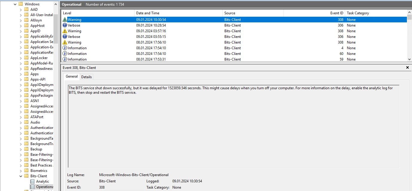

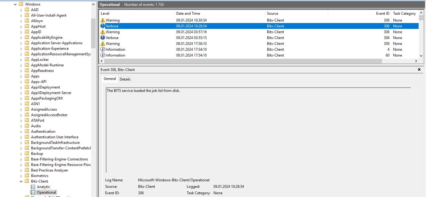

    In Applications and services/Microsoft/Windows/Bits-Client/Operational logs is a warning: "The BITS service shut down successfully, but it was delayed for 1523859.546 seconds. This might cause delays when you turn off your computer. For more information on the delay, enable the analytic log for BITS, then stop and restart the BITS service."
    ObrazObraz
    Moreover, I noticed that this service is turning off on every of my 3 servers.
