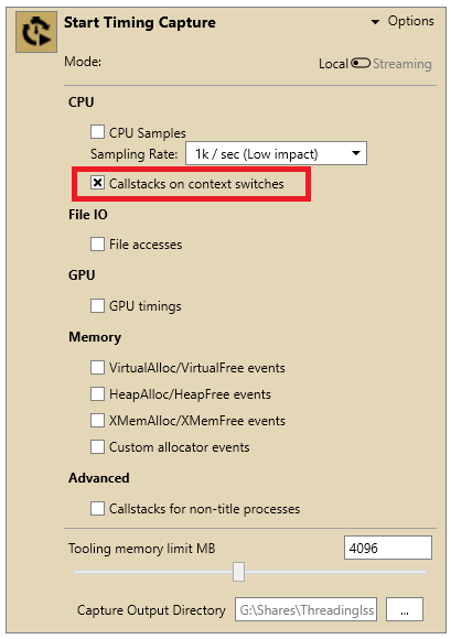

After connecting to a console, the Xbox Connection tab appears with the IP address of the console. Expand the Start Timing Capture section by selecting Options as shown in figure 1.
Figure 1. Shows the Start Timing Capture tab in PIX
Ensure that Callstacks on context switches is selected.
Select the stopwatch icon to begin the Capture. In the System Monitor view, there's a highlighted section of the graphs that represents the time frame that's being Captured.

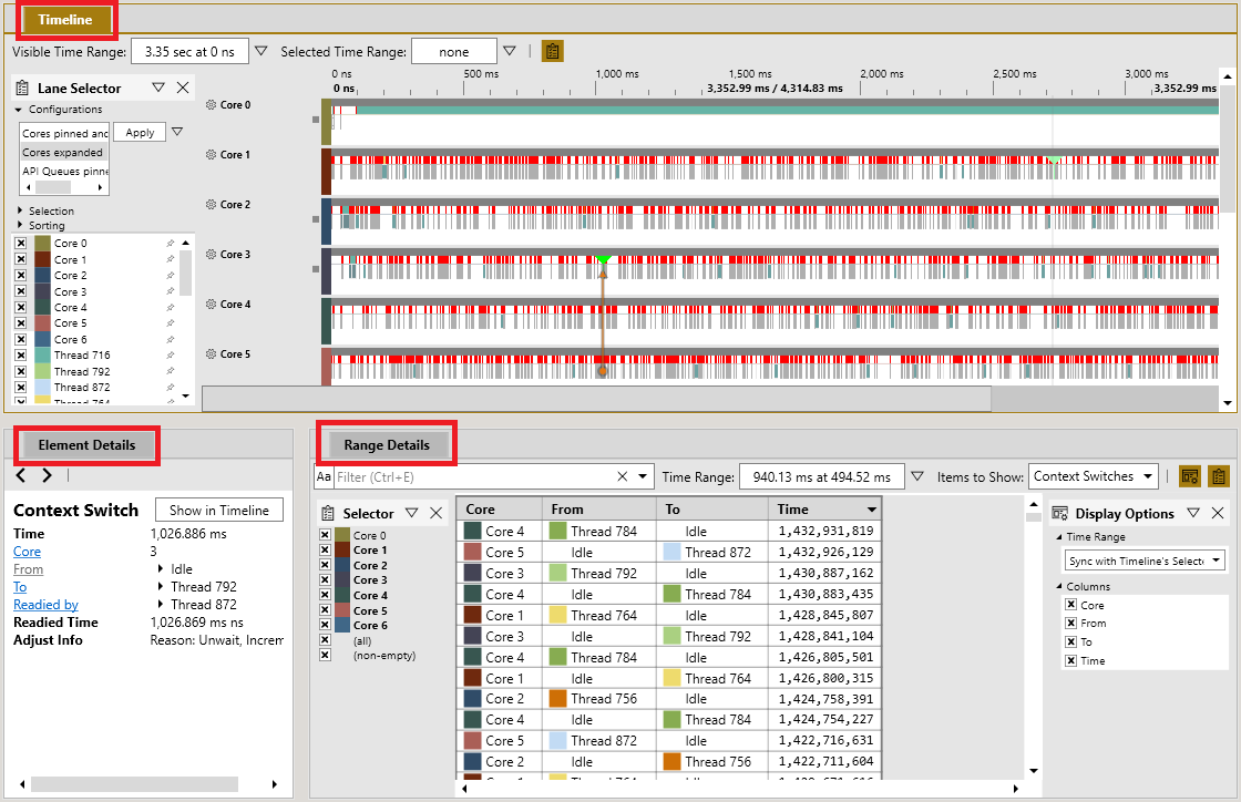

When you have Captured enough data, select the stopwatch icon again to stop the Capture. A new tab will open with a timeline view of the Capture as shown in figure 2.
Figure 2. Shows the default view of a Timing Capture in PIX
Note
There are three main views labeled Timeline, Element Details, and Range Details. You can move through the Timeline view to review the timelines for individual threads, by using the wheel button on the mouse to scroll up and down.
Select and move a portion of the timeline to zoom into a region of interest.
- You can also select Zoom to Selected Range from this context menu that appears when right-clicking the timeline.
- You can also edit the Visible Time Range or Selected Time Range directly. You can zoom and navigate the timeline by holding a right-click on the mouse to pan, and selecting Ctrl and scrolling with the wheel button of your mouse.
