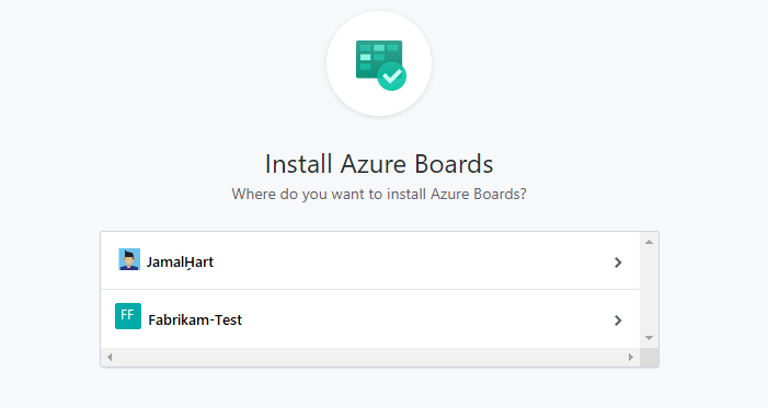

Select Set up a plan.
Choose the GitHub organization you want to connect to Azure Boards.

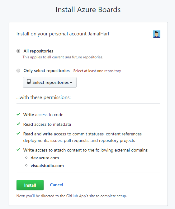

Choose the repositories that you want to connect to Azure Boards.
In the following example, we choose to connect to all repositories.

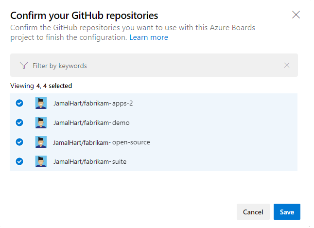

Confirm the GitHub.com repositories that you want to connect. Select each repository you want to connect to. Unselect any repositories that you don't want to participate in the integration.
