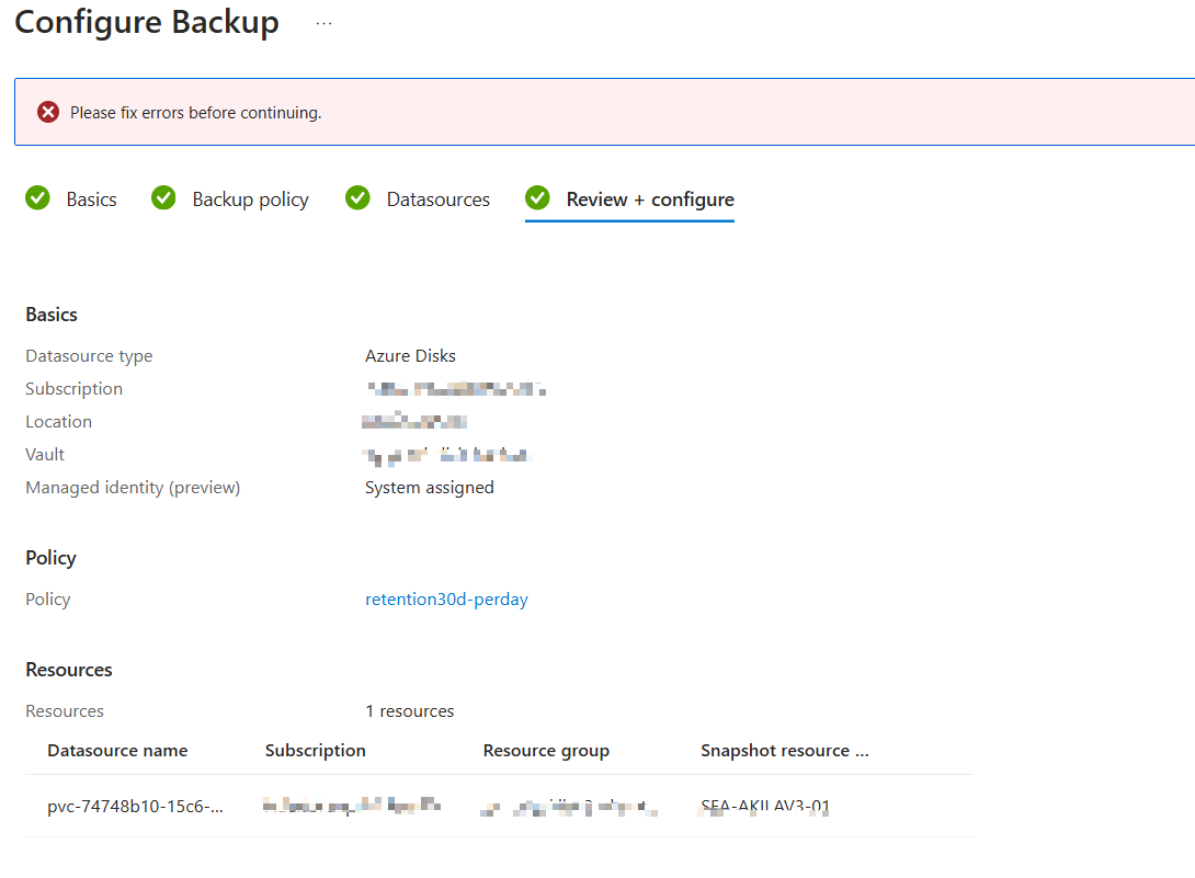

Azure backup disk always prompt "Please fix errors before continuing. "
匿名
2024-11-27T08:01:00.33+00:00
There isn't any error in the screenshot, but it still couldn't continue, I don't know why after searching on the Internet.
用户的图像
The Role assignment is complete and validation is also passed.
Could anyone give me a hint? Thx

    It sounds like you're encountering an issue with Azure Backup for your disk.
    Here are some steps to help you troubleshoot and resolve this error:
    • Ensure that the Backup vault's managed identity has the necessary permissions on the disk and the snapshot data store resource group. This is a common cause of such errors
    • Make sure the resource group for the snapshot data store exists and is correctly configured. Sometimes, the error occurs if the resource group is missing or has incorrect settings

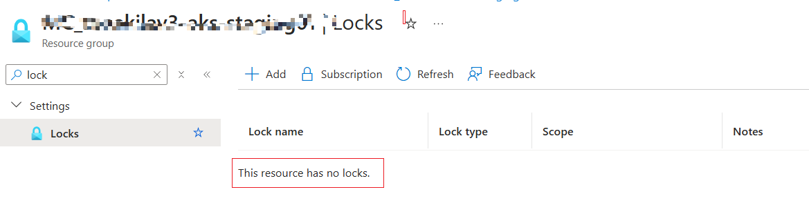

    • If there are any delete or read locks on the snapshot resource group, remove them. These locks can prevent the backup operation from proceeding

    Thank you all. I've solved this issue by create a new resource group for snapshot.
