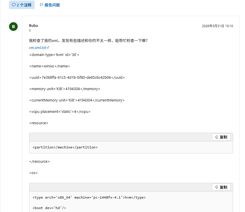

    I have reviewed your updated configuration. Indeed, <acpi/> and <apic/> are properly configured.
    Regarding the Hyper-V Enlightenments and the reset state parameter you mentioned, they need to be placed inside the <features> tag.
    For Windows VMs running on KVM, enabling Hyper-V enlightenments is crucial. It allows KVM to emulate a Hyper-V environment. When Windows detects this, it uses specially optimized low-level interfaces, which significantly improves performance and reduces the chances of system freezes or Blue Screens of Death (BSOD).
    Here are the specific modifications I recommend:
    1. Add Hyper-V Enlightenment Parameters
    Please modify your <features> section to look like this (this includes the reset parameter you mentioned):
    <features>
    1. Add Hyper-V Clock: Since you are enabling the Hyper-V module, it is recommended to add hypervclock inside your <clock> tag. This helps resolve time drift and high CPU usage issues within the Windows VM:
    <clock offset='utc'>
    1. You mentioned trying to modify the memballoon, which is an excellent troubleshooting approach. Windows compatibility with the Virtio memory balloon driver can sometimes trigger instability or BSODs due to its memory reclamation mechanism (especially when the host system experiences memory pressure).
    To rule out this interference, you can completely disable it for now. At the bottom of the <devices> tag, change the original:
    <memballoon model='virtio'>
    to:
    <memballoon model='none'/>
    I suggest making these three modifications first, then use virsh define to redefine the VM and start it up for testing.

  2. VPHAN 36,090 信誉分 独立顾问
    2026-03-31T07:17:42.1866667+00:00
    布布
    你分享的XML段只包含配置文件底部的虚拟硬件设备块。负责电源管理和重启信号的关键设置实际上位于XML文件的最顶部,在操作系统和功能部分,而这些设置在你的代码片段中是缺失的。你需要往上滚动到配置顶部,找到功能标签。在该部分内,确保ACPI和APIC电源接口都被显式启用,并确认Hyper-V启蒙模块中重置状态参数设置为开启,从而允许Windows内核成功处理KVM软重启。
    仔细看你提供的硬件部分,VirtIO内存气球设备非常可疑。VirtIO 气球驱动经常在 Windows Server 2019 环境中的 KVM 环境中导致重启死锁,因为它在软重启初始化时未能将锁定的内存页释放回主机。你应该在XML配置中修改memballoon标签,把model属性从virtio改为无。完成这些调整并保存配置后,完全关闭虚拟机,并从Kylin主机重新启动,应用新的硬件拓扑。
