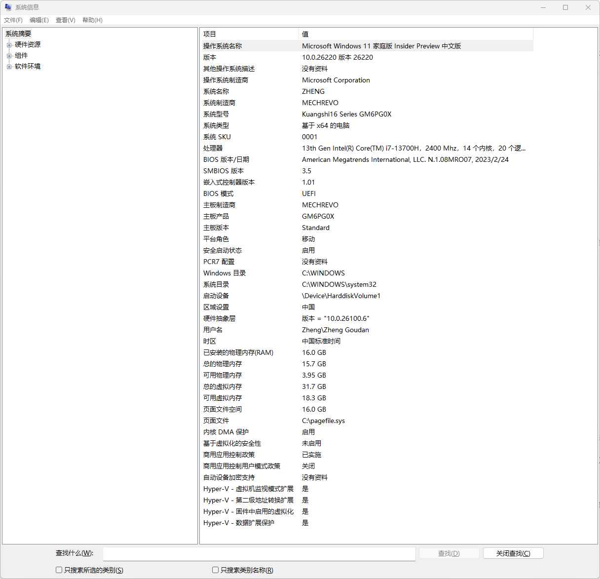

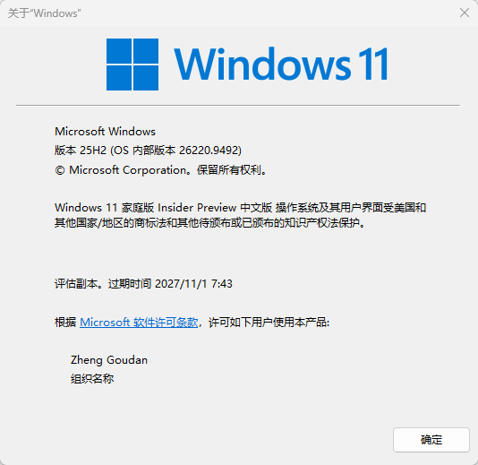

    Thank you for the screenshots.
    Based on the screenshots, you are using Windows 11 Insider Preview build.
    Previously, a similar black-screen problem with secondary monitors was a known issue, so the Insider build may be involved, although it is not listed for this exact build.

    如果情况持续,请点击开始>输入系统信息,按下回车>截图,然后回发。
    点击开始>输入winver,然后回车>截图,然后发回来。
