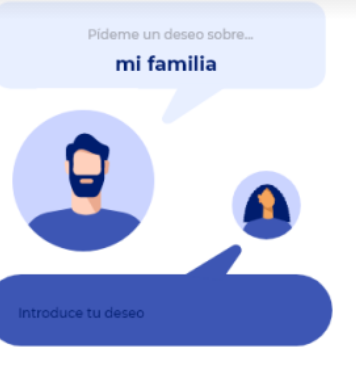

Hey dude @Anonymous
Do you think you could help me make this UI please

It seems that LeonLu has provided the code about how to design the bubbles in this thread. The bubble is design via drawing two cubic Bezier curves, you can specify different points to change the shape of bubble. For more detail, you could refer to this doc.
To design the UI as the picture shown, you could use a relativeLayout to define the position of each view. Or just use stackLayout as the parent and set the HorizontalOptions the head icon to Start or End. Adjust the direction of the bubble of the chart cell to make it point to the head icon.
