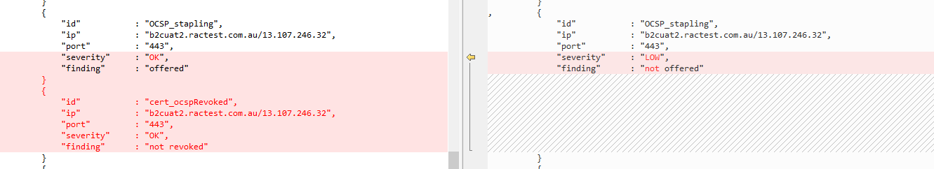

However despite the above, I was able to reproduce the pen testers findings when using ssl testing tools, like https://github.com/drwetter/testssl.sh, or Qualys https://www.ssllabs.com/ssltest/
Both of these report ocsp stapling was not offered. Subsequent runs may have the response stapled.
The above is the diff of 2 runs of the testssh.sh output in json. Note the inconsistency.
I would like adopt OCSP Must-staple at some point, however this is impossible if we aren't getting consistent ocsp stapling.

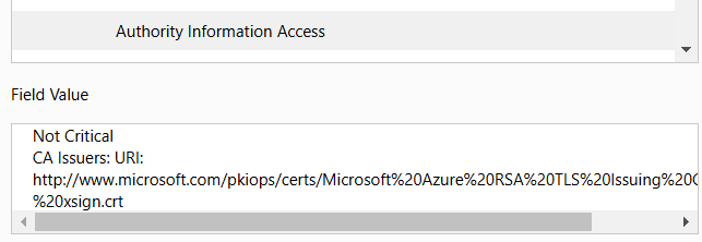

    • Also, from the browser, I can see Authority Information Access

    The potential reason that SslLabs could be pointing that OCSP must staple is "No" because in first request to AFD, will not have OCSP response cached for the machine. So, it'll not respond with stapled OCSP response. For subsequent requests until cache is not evicted, responses will have the OCSP status.
    The Product Team is aware of such behavior, and are working on it (as of now, we don't have an ETA)
