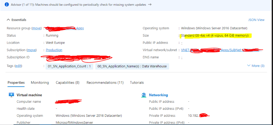

VM Configuration:
Looks like, that we don't have any firewall rules that can block web traffic. I can successfully test the connection between our production VM and this BLOB:
