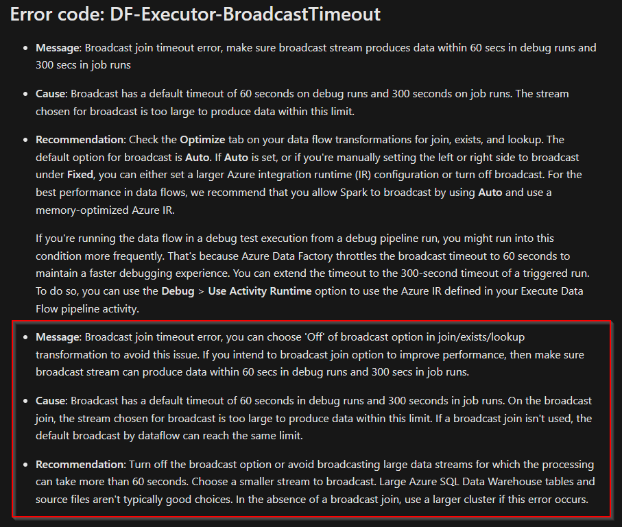

    Please note that broadcast has a default timeout of 60 seconds in debug runs and 300 seconds in job runs. From the error message the stream chosen for the broadcast seems too large to produce data within this timeout limit.
    If you experience broadcast timeouts during data flow executions, you can switch off the broadcast optimization. However, this will result in slower performing data flows.
    When working with data sources that can take longer to query, like large database queries, it is recommended to turn broadcast off for joins. Source with long query times can cause Spark timeouts when the cluster attempts to broadcast to compute nodes. Another good choice for turning off broadcast is when you have a stream in your data flow that is aggregating values for use in a lookup transformation later. This pattern can confuse the Spark optimizer and cause timeouts.
    Here is the troubleshooting guide related to this error message: Error code: DF-Executor-BroadcastTimeout
