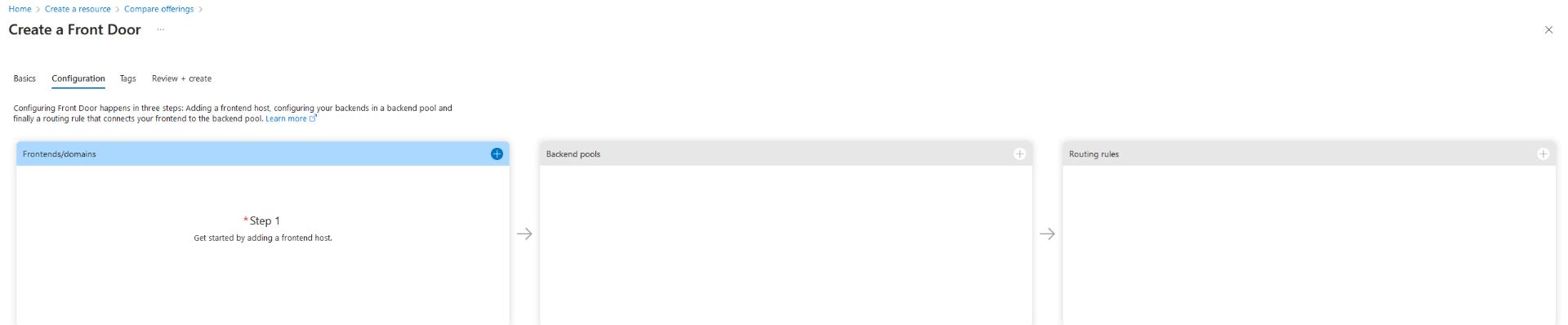

I am a beginner using Azure. Have set up an App Service WordPress site with custom domain. Need to set up and try out Classic Front Door (add it and configure it) to integrate with this already running WordPress App Service so that I can add access restrict rules to prevent direct access to content on the backend. Possibly WAF also, although since Classic Front Door will double my monthly costs, and may not once added and configured achieve the needed result, may wait on adding WAF (which will triple monthly costs) until after checking first on Classic Front Door results.
Have found the location in my portal to add and begin to configure Classic Front Door but, as a beginner, I am not sure what to enter into the fields to integrate with my current App Service WordPress? Some ideas here, but still not sure: https://gunnarpeipman.com/wordpress-azure-front-door/
screenshot
Hoping not to make a "mess" that then needs to be unraveled, canceled and redone. Or worse yet, corrupts the App Service WordPress site.

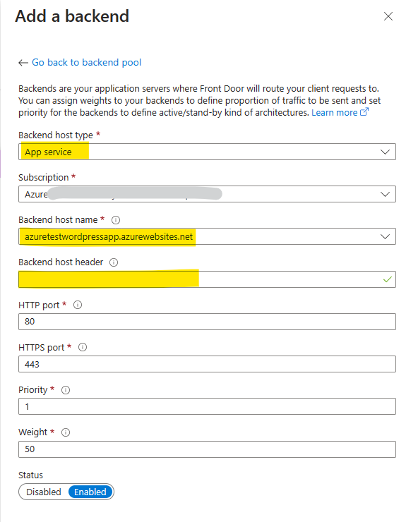

    But since you mentioned you would like to use Classic Azure Front Door, you can manually create a Front Door and add the app service in it's backend.
    You can follow the below doc or this blog for the configuration:
    https://learn.microsoft.com/en-us/azure/frontdoor/quickstart-create-front-door
    Note: The above doc shows how to add 2 webapps but you can just one in the same way.
    Azure recommends that you preserve the original HTTP host name when you use a reverse proxy in front of a web application. Having a different host name at the reverse proxy than the one that's provided to the back-end application server can lead to cookies or redirect URLs that don't work properly.
    So, when you use an App service with custom domain behind the Azure Front Door, you can avoid overriding the host name by leaving the back-end host header blank in the back-end pool definition as below:
    Refer: https://learn.microsoft.com/en-us/azure/architecture/best-practices/host-name-preservation#azure-front-door
