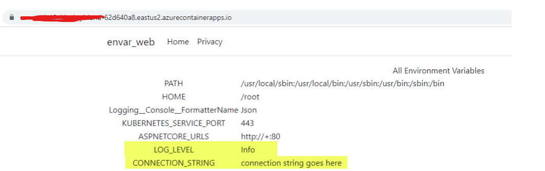

    @Sowndar kumaresan Thanks for getting back and sharing the details. in the non-working ( higher) scenario, Could you please try to **list **the environment variables and check if it has been set correctly ?
    Run the below command and then try to access the FQDN:
    az containerapp revision list \
      --name $CONTAINERAPPS_NAME \
      --resource-group $RESOURCE_GROUP \
      --query "[].{Name:name,DateCreated:createdTime,ProvisionStatus:provisioningState,Traffic:trafficWeight,Active:active,FQDN:fqdn}"
    While accessing the FQDN from browser it should list the env variables and its value. See an example below:
    enter image description here
