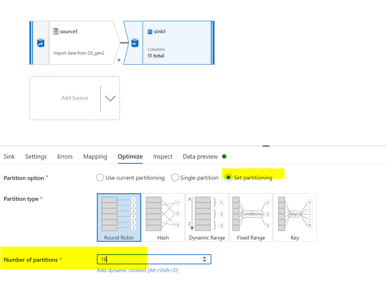

Hi . I have a requirement of loading a json file (approx 4 GB) to a Cosmos DB. I want to compare the data schema (column structure) against a defined data structure before loading the file into the DB. I am trying to use Dataflow to achieve this but I end up facing a OOM exception (below is the complete message) even when I selected the highest core count and Memory optimized Compute in my pipeline settings for DataFlow. Looking for suggestions to achieve this in some other better way or if Dataflow is the only way, how to overcome the Spark OOM error?

    Hello Azharudheen r, Mohamed,
    Yes, you are correct. You can set partitioning at the Dataflow level but can define cluster configuration in the pipeline settings only.
    As the next steps, can you please check if you can break down the 4GB file into smaller files?
    and to take advantage of partitioning, the structure the json needs to be one document per line.
    By the way there is 2GB limit for block size on spark, so a row cannot be more than 2GB.
