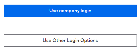

We are currently being forced to use the SSO login instead of getting prompted to choose between "Use company login" or "Use Other Login Options" to authenticate.
