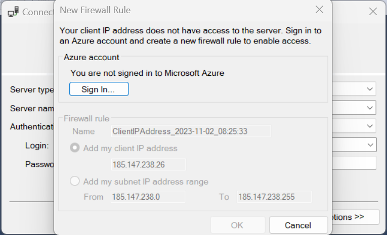

I have created a SQL server and database in Azure and i have established and configured a Private Gateway and configured Azure VPN client on my on prem computer.
I get a succesfull connection in the VPN client vut i still can not reach the dtabase in SMSS despite the VPN being connected.

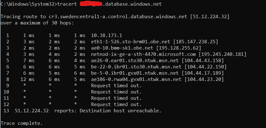

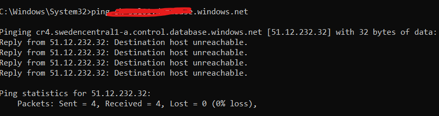

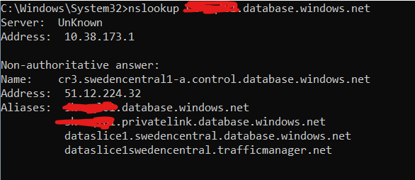

    From your ping results, we can see that,
    • <yourSqlServerName>.database.windows.net is resolving to the Public IP of the SQL server
    • This is not ideal, we need it to resolve to the Private EndPoint's IP of the SQL server

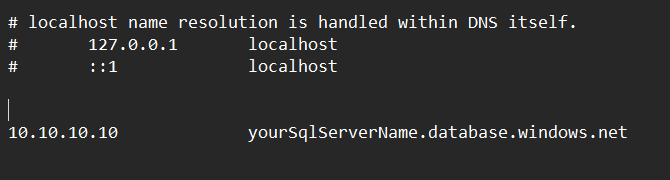

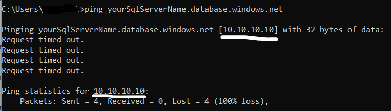

    If you are trying to access a PaaS service from OnPrem via S2S or from a remote client via P2S, it is mandatory that you configure the DNS resolution at your end to resolve to the Private IP of the Private EndPoint
    • Modifying the Windows Host file is one of the ways to do the above.
