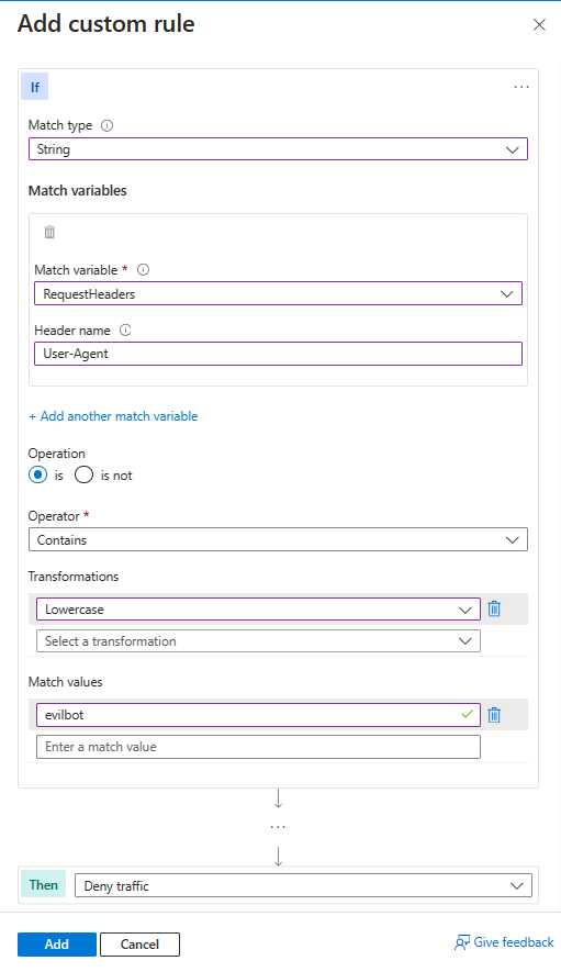

    So, I would request you to go through your WAF rules and validate the requests and if you believe that legitimate traffic is getting blocked, you can create custom rules to allow that particular traffic.
    Refer: https://learn.microsoft.com/en-us/azure/web-application-firewall/ag/web-application-firewall-troubleshoot
    Application gateway WAF custom rules: https://learn.microsoft.com/en-us/azure/web-application-firewall/ag/custom-waf-rules-overview
    Azure Front Door WAF custom rules: https://learn.microsoft.com/en-us/azure/web-application-firewall/afds/waf-front-door-custom-rules
