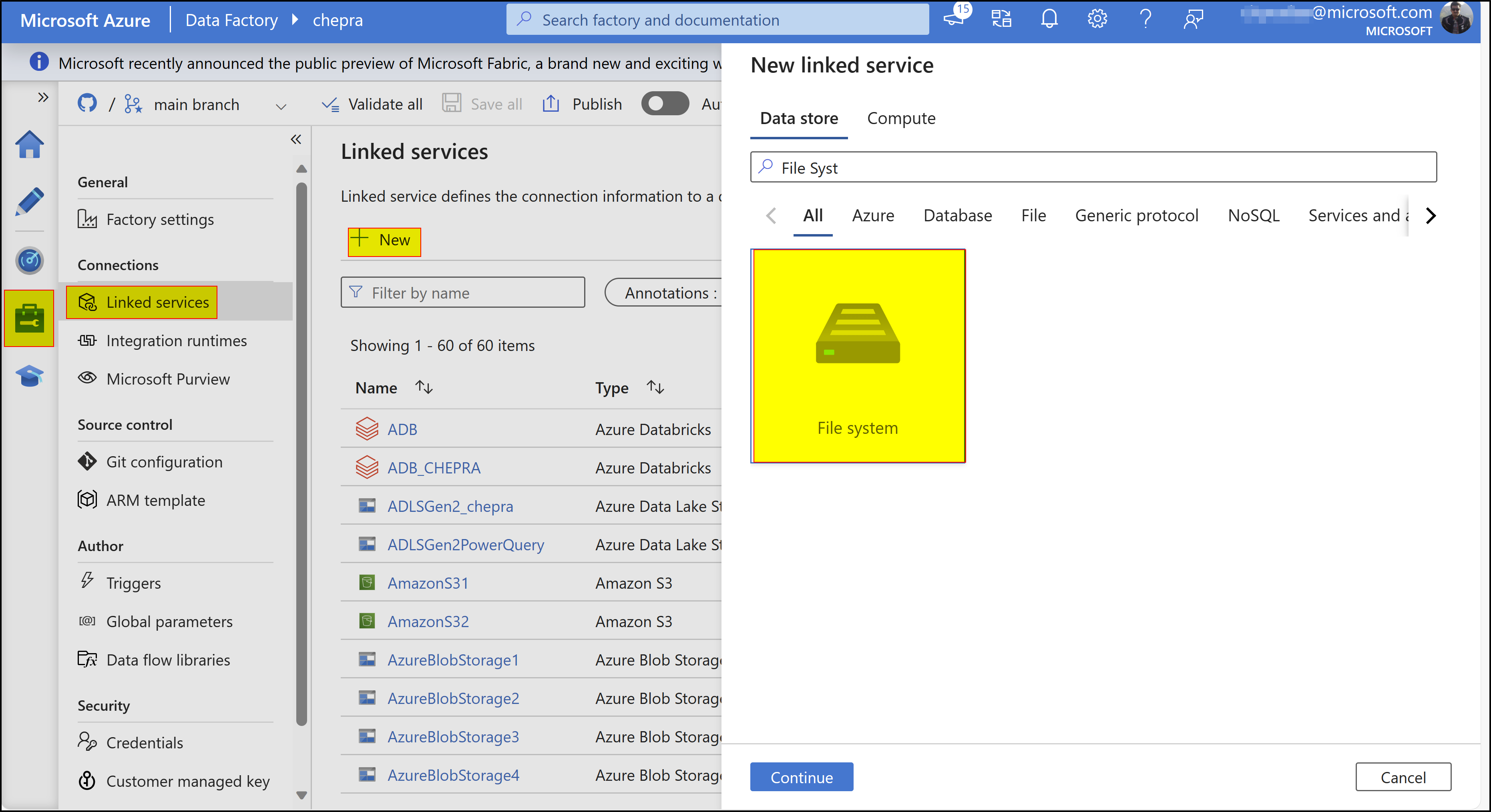

    If you are looking for a solution to connect to folder in window servers which is on-premise you can use Azure Data factory to connect via file system connector using SHIR. User's image

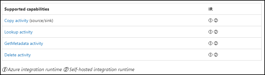

    Azure Data Factory file system connector supported for the following capabilities:
    • Copying files from/to network file share. To use a Linux file share, install Samba on your Linux server.
    • Copying files using Windows authentication.
    • Copying files as-is or parsing/generating files with the supported file formats and compression codecs.
    For more details, refer to Copy data to or from a file system by using Azure Data Factory or Azure Synapse Analytics.
