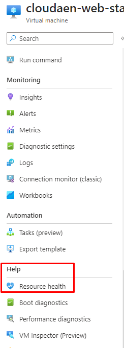

  1. Dillon Silzer 57,831 Reputation points Volunteer Moderator
    2023-11-26T19:29:54.1633333+00:00
    Hi John,
    Have you tried manually restarting it from Azure UI? Navigate to your VM through the Azure UI > press Restart:
    Also, try checking your resource health under Help > Resource health
    Also, you might want to check your Logs through the UI to find out what is happening or if you are having a resource issue. If you have a cheaper VM, you may be pinning the resources and therefore it is kicking you off due to a lack of resources on the server.
    If you are still unsure, you could open a ticket with Azure Support (you will need a support plan):
    https://azure.microsoft.com/en-ca/support/create-ticket
    If this is helpful please accept answer.
