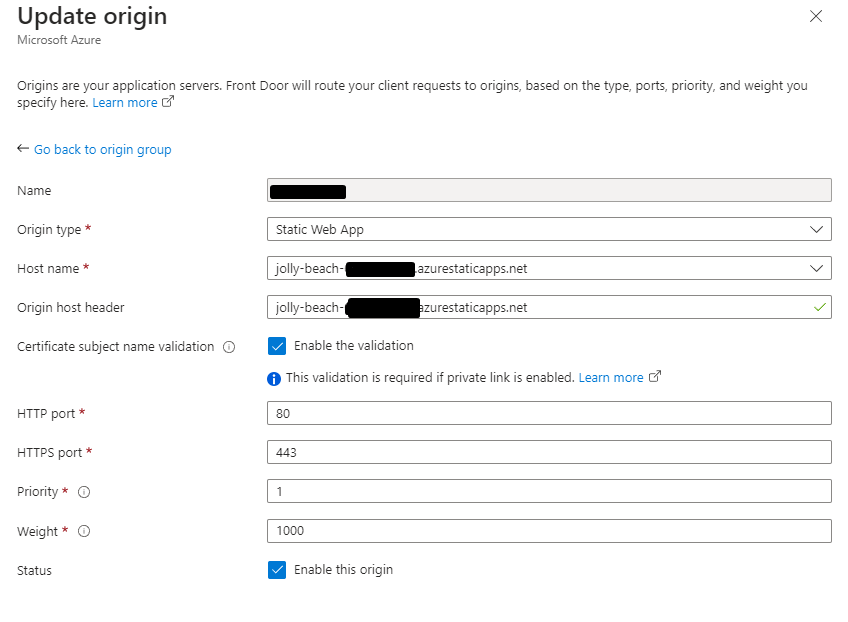

Everything work well, both on localhost and on the azurestaticapps domain. Now, I want to support multi tenancy with my app using custom domains. So I created a Front Door and CDN profile (Standard) to define these. I successfully validated a couple of subdomains using TXT records. Also added a CNAME record to control the flow of traffic to the Front Door. Then, I added an origin group, endpoint and route pointing to the static web app, as seen below.User's image
After associating the custom domains, I can visit tenant1.custom-domain.com or tenant2.custom-domain.com and public traffic is served correctly for each tenant. Notice that the Origin host header value is the default, host name.

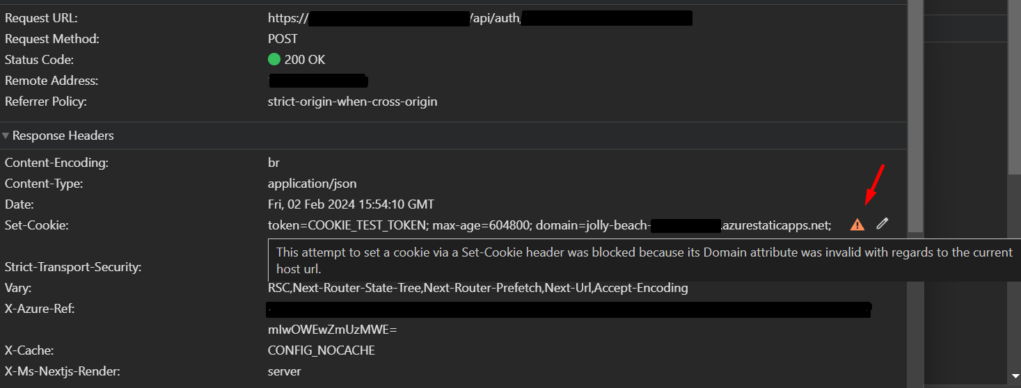

When fetching api/auth on tenant1.custom-domain.com the cookie domain gets auto set to the static web app domain. And because jolly-beach-hidden.azurestaticapps.net is different than tenant1.custom-domain.com the browser treats the cookie as invalid, as shown below: User's image
I am not able to set cookie and thus my whole multi tenant authentication isn't functional.
I tried setting the correct domain (tenant1.custom-domain.com) manually in the Set-Cookie header but that doesn't seem to work - the token cookie is not visible in Chrome Dev Tools. My guess is Front Door is discarding this cookie before reaching the browser.

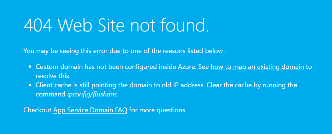

I also tried changing the Origin host header on the origin from jolly-beach-hidden.azurestaticapps.net to tenant1.custom-domain.com but then if I visit tenant1.custom-domain.com I will get a 404 Azure error. I also tried leaving the field empty in the hope that it will be set automatically to the request host but that also causes the same 404 error.
