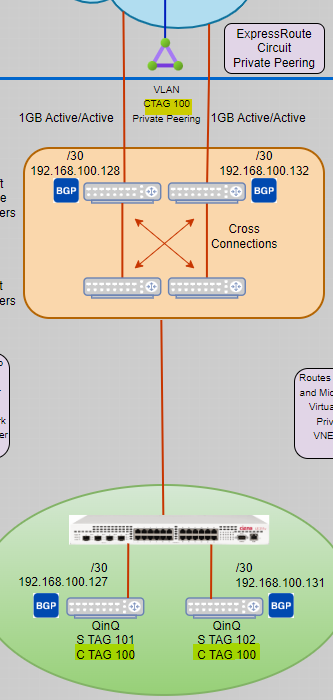

We are trying to configure azure expressroute. I have a provisioned circuit. We are using one epl connection via Comcast. From what I see in the documentation we need to configure to /30 networks. 0ne ip for our router and one for msee router we need two on each side to account for the redundant connections on the Microsoft side. the fact we have only one epl I assume would mean we need to be able to pass two vlans (one for each of our side /29 networks. These need to be separate/different vlan tags. When looking at the private peering on the Circuit it asks for each /29 (primary and secondary) but only asks for one vlan tag. since we need two different tags to account for each /29 on our side what is Microsoft expecting for the value on the circuit vlan field?

    Your service provider can establish two Ethernet virtual circuits over the physical connection. The physical connection (for example, an optical fiber) is terminated on a layer 1 (L1) device. The two Ethernet virtual circuits are tagged with different VLAN IDs, one for the primary circuit, and one for the secondary.

    • A valid VLAN ID to establish this peering on. Ensure that no other peering in the circuit uses the same VLAN ID. For both Primary and Secondary links you must use the same VLAN ID.

    So basically, we are using a pair of VLAN subinterfaces with the same VLAN ID and different /30 subnets for primary and secondary BGP sessions/peerings.

    And you need to verify that the customer (C-Tag) and service (S-Tag) VLAN tags match both on MSEE-PR and MSEE pair.

    You can use any valid number as the VLAN ID to establish the peering (such as 5, 100, 152 etc). For both Primary and Secondary links, you must use the same VLAN ID. This VLAN ID configured by you in the Azure portal is called C-tag or customer tag because it is customer defined.
    NOTE: Make sure that no other peering in the circuit uses the same VLAN ID.
    Once configured, you need to share this VLAN ID and s-key of the ExpressRoute circuit with your service provider for them to configure it in the routers. The VLAN ID configured on the portal should match with the ones configured in the routers for the ExpressRoute ARP (Address Resolution Protocol) to come UP.
    The VLAN IDs defined by you in the Azure portal are different than the VLAN IDs at service provider end. The ones defined by you in the portal are the inner tags called customer tag (c-tag) and the ones at service provider ends are the outer tags or service provider tag (s-tag). The VLAN IDs configured by you in the portal must be same for both Primary and Secondary links (this is for the routing domain/peering and not for the circuit).
