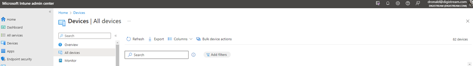

Hi, I have Microsoft Entra hybrid joined windows device that have stopped getting a MDM. I was able to determine that Zoho EPC had assigned a MDM to my devices. I contacted EPC support and they gave me a script to remove the Zoho EPC MDM and that worked for a bit. As I started adding windows machines by enabling secure boot, verifying reagentc was enabled, and the local disk was not encrypted. I also ran the command dsregcmd.exe /debug /leave on these machines. I checked the reg on a couple of these machines for left over MDM information but there was non. I have looked over a couple of the windows machines event logs but nothing stuck out except for one had the message (CanEnroll Error: MDM enrollment is not allowed due to failed access check(administrator or allowed user, capability check) with HRESULT: (Access is denied.). I wasn't able to find anything online regarding this issue. When look at the windows device in azure the settings are: Enable = Yes, OS = Windows, Version = 10.0.19405.4046, Join Type = Microsoft Entra hybrid joined, Owner = n/a, user principal name = none, MDM = none, Compliant = n/a, registered = 2/28/24, activity = 2/28/24, group = none. I ran the command dsregcmd /status AzureADjoined = yes, Enterprised joined = no, domain joined = yes. The MDM and MAM are setup according to the documents. I just can't figure out why these machines are not getting a MDM enrolled. Any help would be greatly appreciated. Update - I did find the Event ID 98 on one of the windows devices, anyone know how to resolve it?

    I notice you mentioned 71 of the Windows devices have MDM. Could you let us know if the MDM is Microsoft Intune? Are these devices appearing in Intune portal ?https://intune.microsoft.com/#view/Microsoft_Intune_DeviceSettings/DevicesMenu/~/allDevices

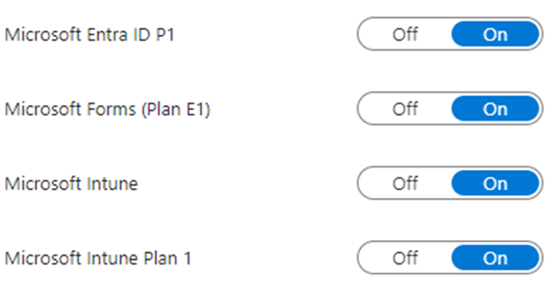

    For the license, I notice it is not one which include Microsoft Intune Plan 1 license. Please go to double confirm on this.
