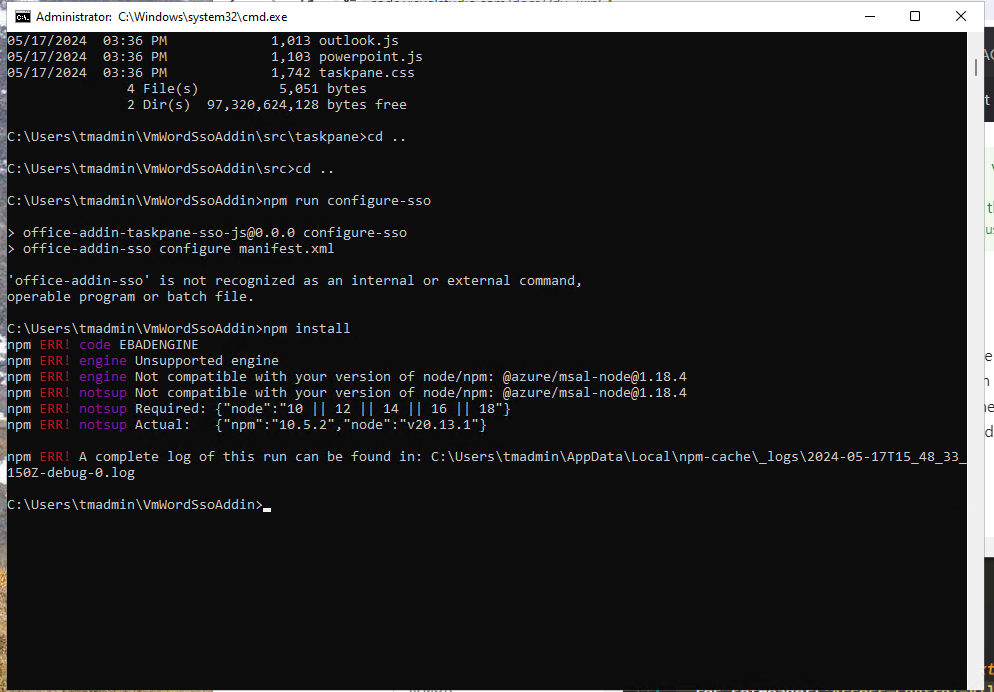

I still do not have it working. Here are some observations from debugging:

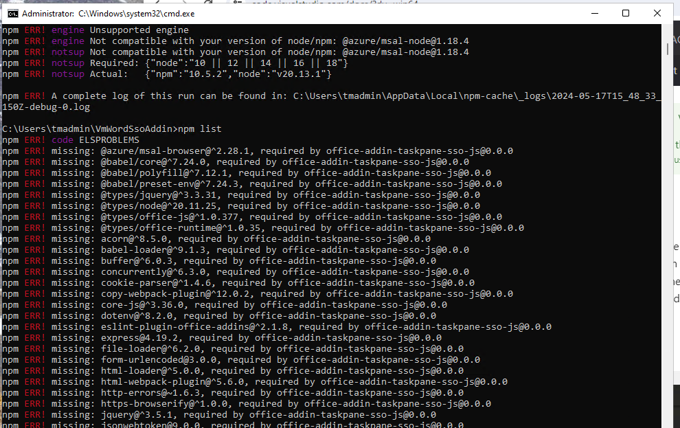

  • You need to ensure you are using node.js 18.x, not the current LTS (20.x), or the configure-sso command will fail.
  • The current version of yeoman is 5.0, but I installed 4.x as specified by this exercise.

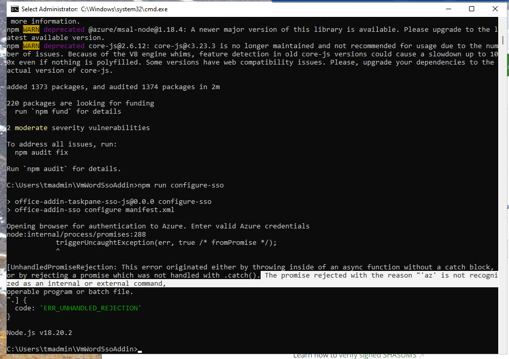

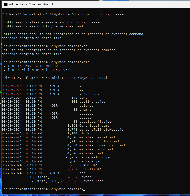

  • You need to run "npm install" in the project directory before running "npm run configure-sso" or the configure-sso command will fail.

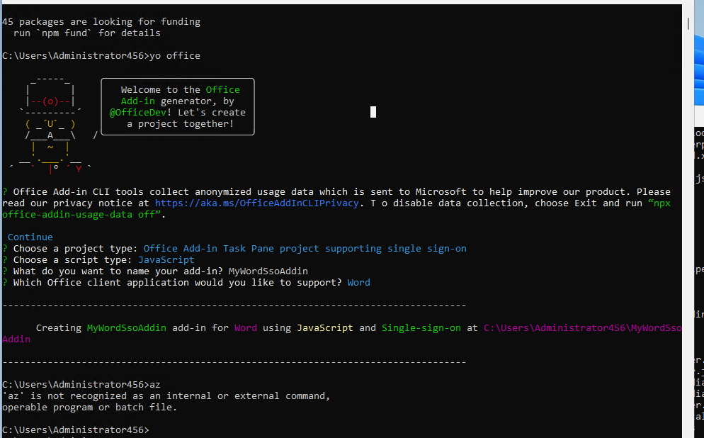

  • You need to install Azure CLI or configure-sso will fail.
  • You need to remove the .azure directory from your home directory (if you are using a new or different Microsoft username for testing purposes).

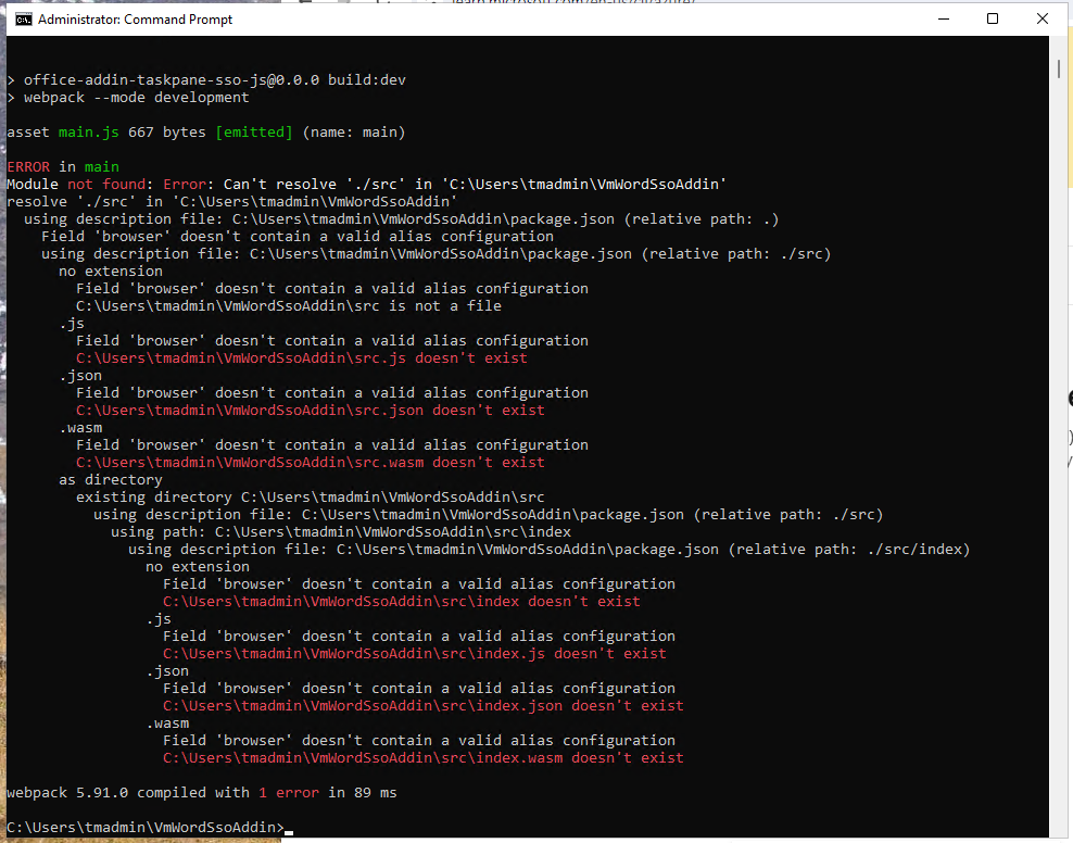

  • After the above fixes and workarounds, the app was successfully registered in Azure. But now "npm start" fails.
  • You need to create an empty index.js file in the src directory, or "npm start" fails with many errors.

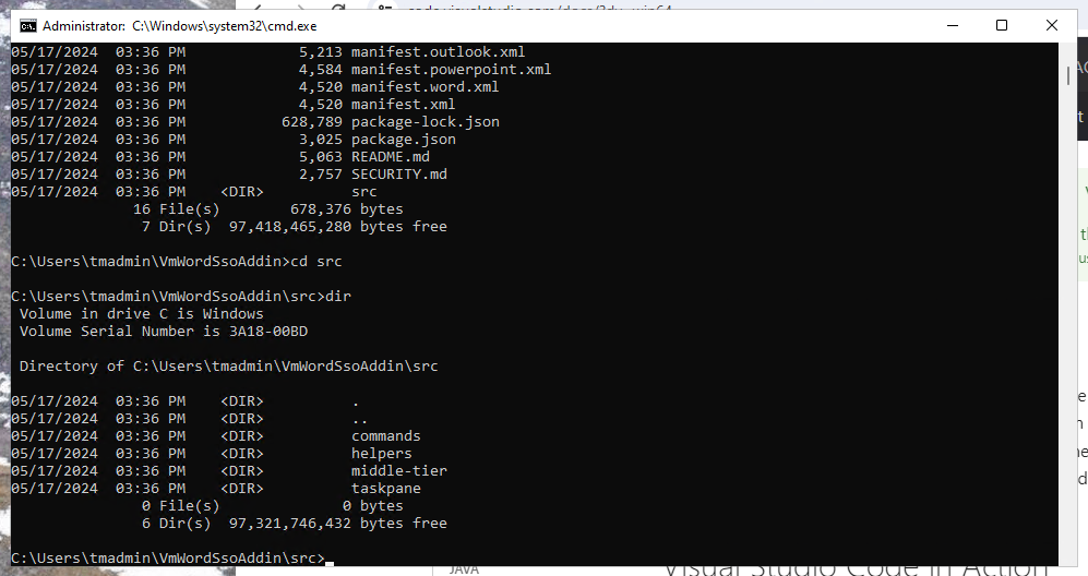

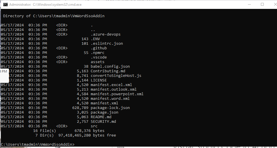

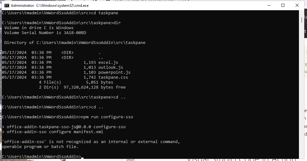

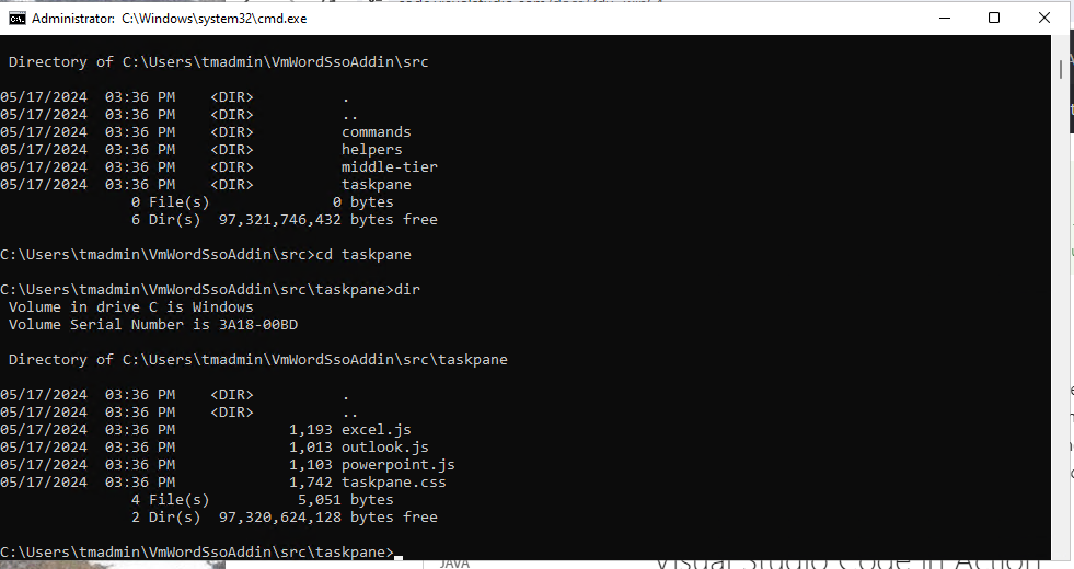

  • From "Explore the project", file src/taskpane/taskpane.html does not exist, and neither does taskpane.js.
  • There are only two files in src/taskpane, one for Excel and one for Outlook, but this is a Word exercise.
  • "npm start" is unable to start the dev server.
  • "npm start" is unable to start debugging.
  • "npm start" is unable to sideload the Office Add-in.
  • "npm start" says Excel is not supported, but this is a Word exercise.

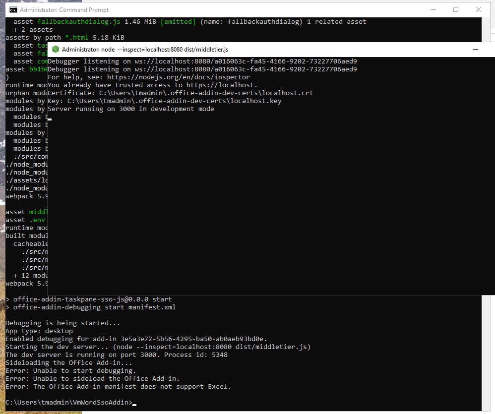

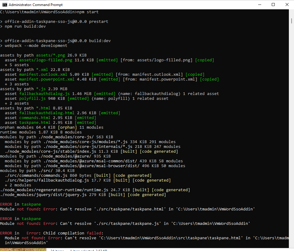

Here are the errors from "npm start". I have nothing running on port 3000. I have tried as administrator and as non-administrator. I am using Windows 11. I installed Python and all other packages that were part of the node.js 18 installation (e.g. Visual Studio code).
C:\Users\Username\MyWordSsoAddin>npm start
office-addin-taskpane-sso-js@0.0.0 prestart
npm run build:dev
office-addin-taskpane-sso-js@0.0.0 build:dev
webpack --mode development
asset main.js 1.21 KiB [compared for emit] (name: main)
./src/index.js 1 bytes [built] [code generated]
webpack 5.91.0 compiled successfully in 61 ms
office-addin-taskpane-sso-js@0.0.0 start
office-addin-debugging start manifest.xml
Debugging is being started...
App type: desktop
Enabled debugging for add-in d3e9dc9b-b3e1-493d-ad28-320ffa48634e.
Starting the dev server... (node --inspect=localhost:8080 dist/middletier.js)
Unable to start the dev server. Error: The dev server is not running on port 3000.
Sideloading the Office Add-in...
Error: Unable to start debugging.
Error: Unable to sideload the Office Add-in.
Error: The Office Add-in manifest does not support Excel.

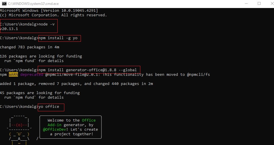

    Thanks to the inputs you provided, we've been able to successfully reproduce the observations and find below along with screenshots:
    1. You need to ensure you are using node.js 18.x, not the current LTS (20.x), or the configure-sso command will fail.
    The current LTS (20.x) supports and can configure SSO without encountering any failures.
    1. The current version of yeoman is 5.0, but I installed 4.x as specified by this exercise.
    The current version of Yeoman 5.0 is functioning well, and versions higher than 4.x will work without any errors. Versions are specified at the time of document/unit preparation.

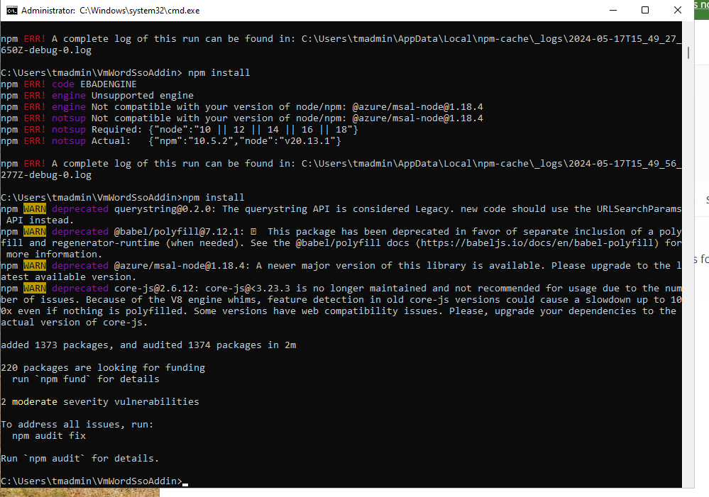

    1. You need to run "npm install" in the project directory before running "npm run configure-sso" or the configure-sso command will fail.
    NPM is installed automatically along with Node.js, eliminating the need for separate installation.
    1. You need to install Azure CLI or configure-sso will fail.
    You can execute the commands in the command terminal/powershell/CLI without requiring any additional tools.

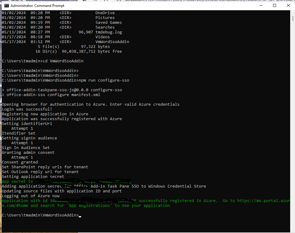

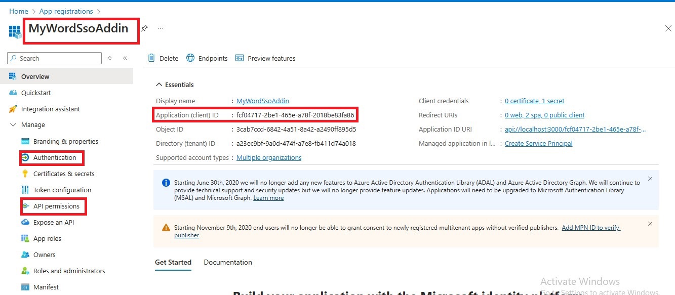

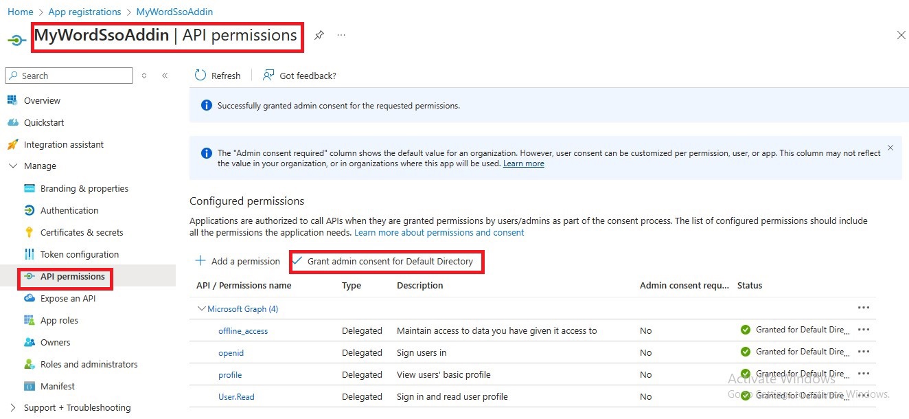

    1. After the above fixes and workarounds, the app was successfully registered in Azure. But now "npm start" fails.
    If you completed the steps above as shown in the documentation or video, you should register the app from the Azure portal. Make sure to do this with administrator privileges and enable the necessary app permissions.
     app1
    grant

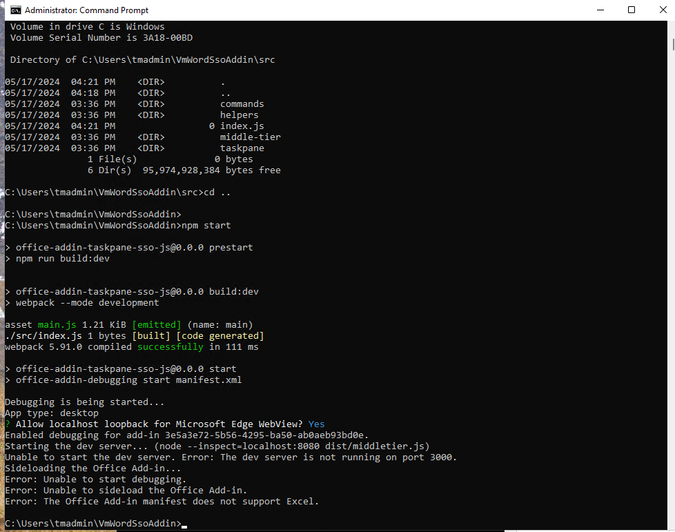

    1. You need to create an empty index.js file in the src directory, or "npm start" fails with many errors.
    You don't have to create any extra files apart from those mentioned in the documentation. "npm start" is not required at this stage.

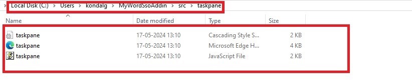

     8. From "Explore the project", file src/taskpane/taskpane.html does not exist, and neither does taskpane.js.
    Files will only be present in the specified folder if the commands are executed without any errors.
    taskpane

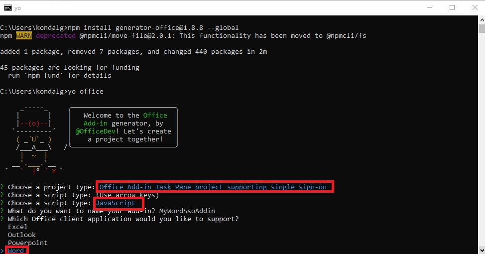

    1. There are only two files in src/taskpane, one for Excel and one for Outlook, but this is a Word exercise.
    When you run the command "yo office," make sure to select "Word" if you're working with Word tasks. Selecting other options like Outlook or Excel will result in an error.
    word

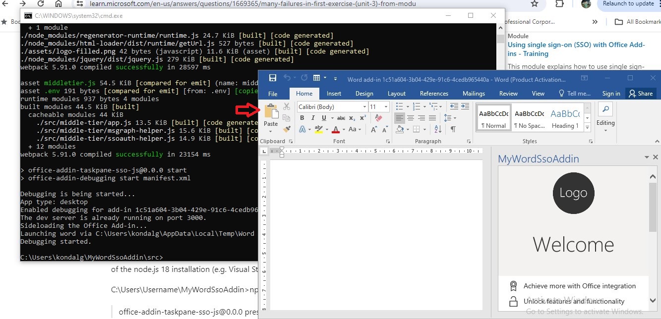

    Running 'npm start' allows you to initiate the development server, debug, and load the Word sideload add-in as shown in below screenshot.
    debug

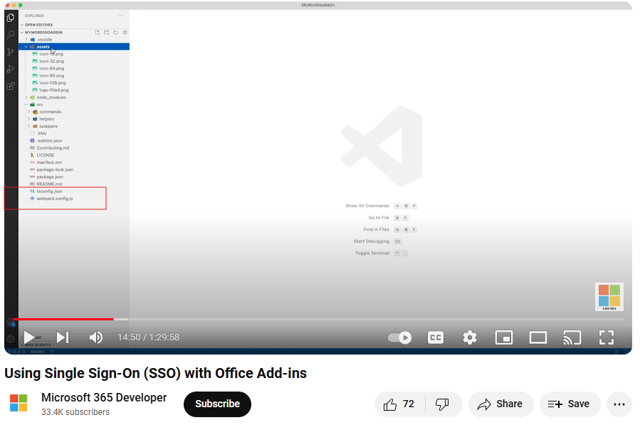

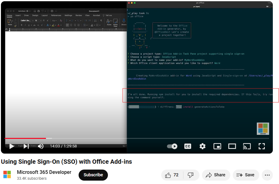

    Ref video: https://www.youtube.com/watch?v=kf_VMt_Eh0M Ref documentation links:
