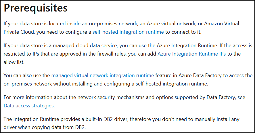

    Please consider the following prerequisites when using the Copy Activity in Azure Data Factory and Synapse Analytics pipelines to transfer data from a DB2 database.User's image For additional information, please refer: Prerequisites.

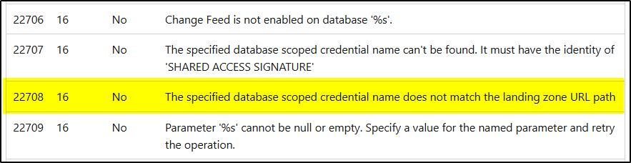

    The error code 22708 in Azure Synapse Analytics typically signifies a mismatch between the specified database scoped credential name and the landing zone URL path.User's image Please refer the Errors and events documentation for more details.
