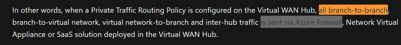

    If you want to route the traffic to Azure Firewall without manually adding routes, you should consider using a vWAN with secured virtual hub with Private Traffic Routing Intent enabled.
    See : Virtual WAN Hub routing intent and routing policies
    Azure Route Server seamlessly integrates with NVAs that can establish BGP Peering with it.
