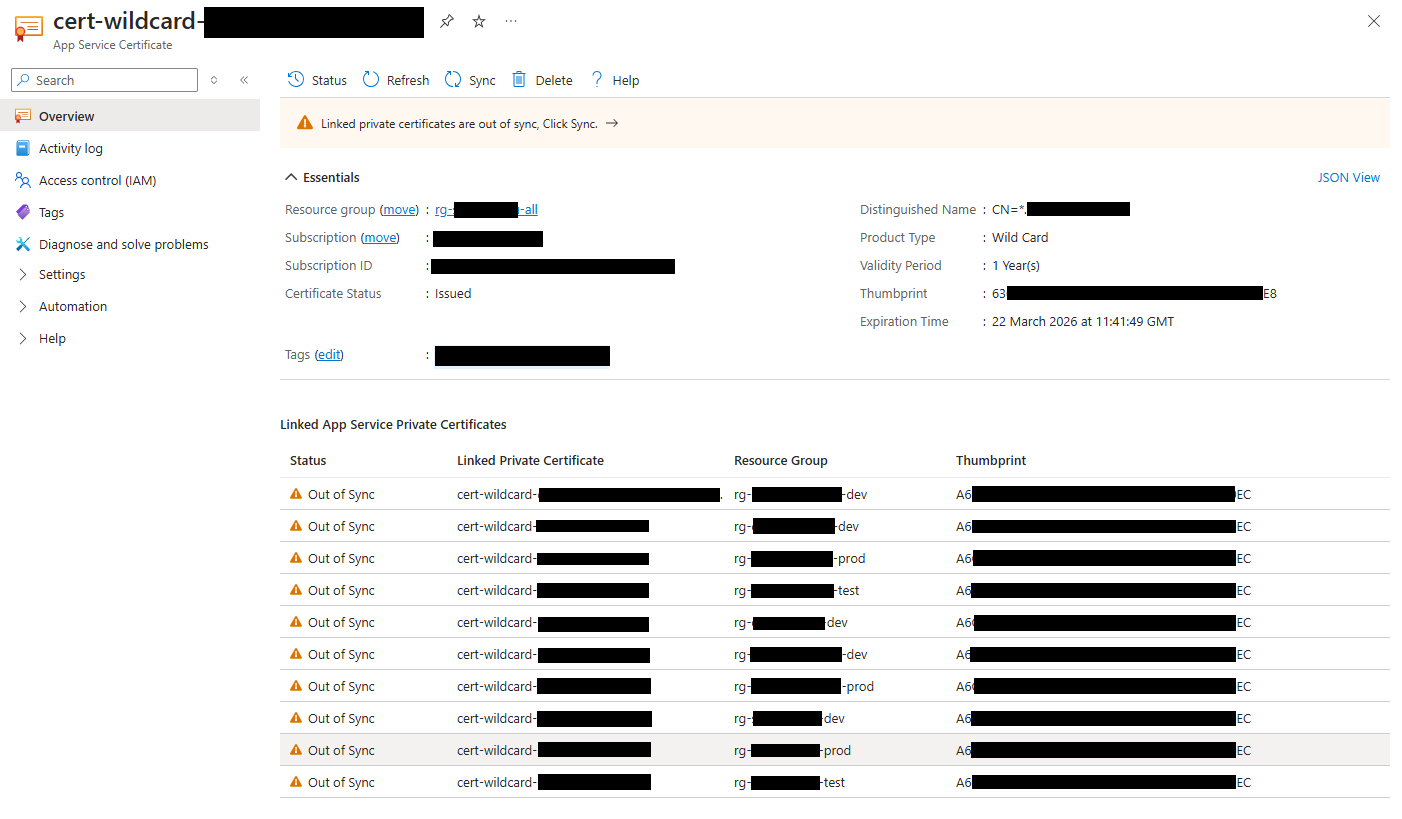

I have a wild card App Service Certificate which has auto-renewed this week. I can see that the linked private certificates haven't yet been sync'd with the new thumbprint of the certificate but as I understand it from reading the documentation, these should get sync'd when the certificate's secret in key vault is updated.

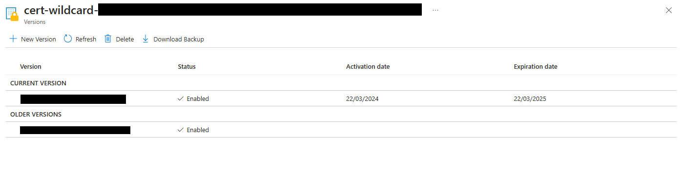

When I look at the secret in Key Vault I can see that the current version has an expiry date which matches the previous cert's expiry date

    I was able to solve this - I suspected that the service used by the app service certificate renewal didn't have permissions to update the key vault secret and turns out I was correct.
    To solve the issue, I had to grant secret list, read and write permissions to Microsoft.Azure.CertificateRegistration (principle id  f3c21649-0979-4721-ac85-b0216b2cf413). Once I did that, when I rekeyed the certificate, the secret value was updated with the new cert and the manual sync resolved the linked app service private certificates.

    Issue :
    The App Service Certificate has renewed automatically, but the secret in Key Vault hasn’t been updated with the new certificate and the linked private certificates still show the old thumbprint.
    Solution :
    • Assign List, Read, and Write permissions on the Key Vault to Microsoft.Azure.CertificateRegistration (Principal ID: f3c21649-0979-4721-ac85-b0216b2cf413).
    • Rekey the certificate to update the secret with the new certificate.
    • Manually sync to update the linked private certificates in the App Service.
