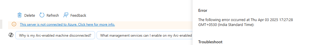

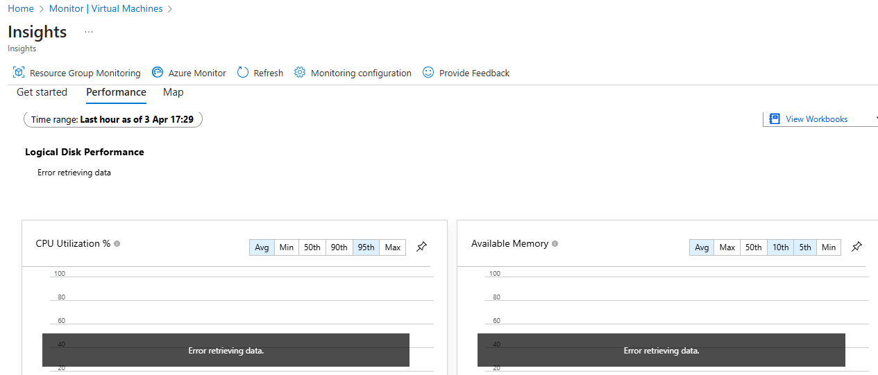

Hi Team,
We are trying to monitor on-prem servers using Azure, For that I installed azure connected machine agent, and I could see the machines are register with Azure arc too but when we see the performance information there "error retrieving data".
I verified from our side the traffic is flowing from on-prem servers IP to below destinations at port 443
Dest:
management.azure.com
*.his.arc.azure.com
*.guestconfiguration.azure.com
And we created the script by selecting private endpoint while generating script from Azure arc. Are we missing anything?
Thanks
Krupa G

    2025-04-09T06:50:35.1366667+00:00
    Hi @krupa gundraju
    I'm glad that you were able to resolve your issue and thank you for posting your solution so that others experiencing the same thing can easily reference this! Since the Microsoft Q&A community has a policy that "The question author cannot accept their own answer. They can only accept answers by others ", I'll repost your solution in case you'd like to "Accept " the answer.
    Issue: Monitoring On-premises servers using Azure monitor
    Solution:
    The issue occurred because Azure Arc private endpoints created private DNS zones incompatible with our custom DNS server, and traffic was also blocked by an internal SD-WAN device; it was resolved by updating DNS records on the custom server and unblocking the traffic

  1. Stanislav Zhelyazkov 29,306 Reputation points MVP Volunteer Moderator
    2025-04-04T05:29:13.93+00:00
    Onboarding to Azure Arc for servers does not automatically enables monitoring. You can see full perquisites of enabling VM insights at: Enable VM Insights. At the end your ARC servers need Azure Monitor agent and dependency agent extensions installed and the data collection rule to be associated with your Arc servers.
