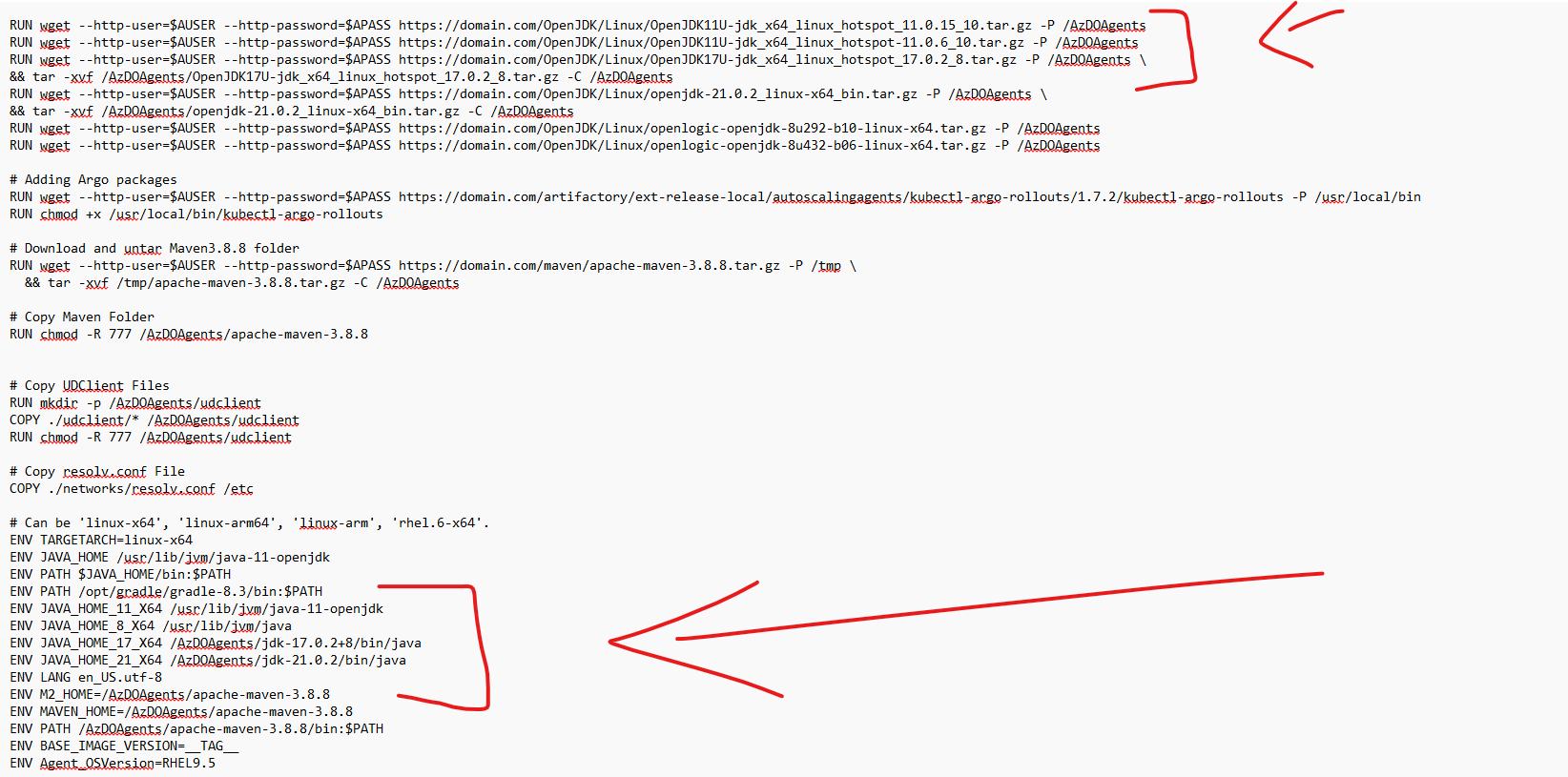

We have extracted Java 17 and Java 21 JDK versions and set up environment variables for both on the Linux agent pool. Now, we want to test the build process using Maven and Gradle tasks. To achieve this, we need to create a build pipeline that can easily run Maven and Gradle builds. Additionally, we require a test repository to validate the setup by running builds with both Java 17 and Java 21 against the agent pool. Could you provide the necessary tasks and suggest a test repository for this validation?

    To resolve the error The JAVA_HOME environment variable is not defined correctly, this environment variable is needed to run this program:
    We need to explicitly set the environment variable for JAVA_HOME to a specific folder-level path, but only for that particular task.

    You can use the GitHub repository https://github.com/spring-projects/spring-petclinic.git which contains both Maven and Gradle build configurations to achieve your requirement.
    If you want to validate the Maven installation and run the build tasks using Java 17 and Java 21 versions, use mavenPath: '$(MAVEN_HOME)' instead of mentioning mavenPath: '$(MAVEN_HOME)'/bin.
    This is to avoid bin/mvn getting appended redundantly which causes the path to be incorrect like /apache-maven-version/bin/bin/mvn and prevents path-related errors during build process:
