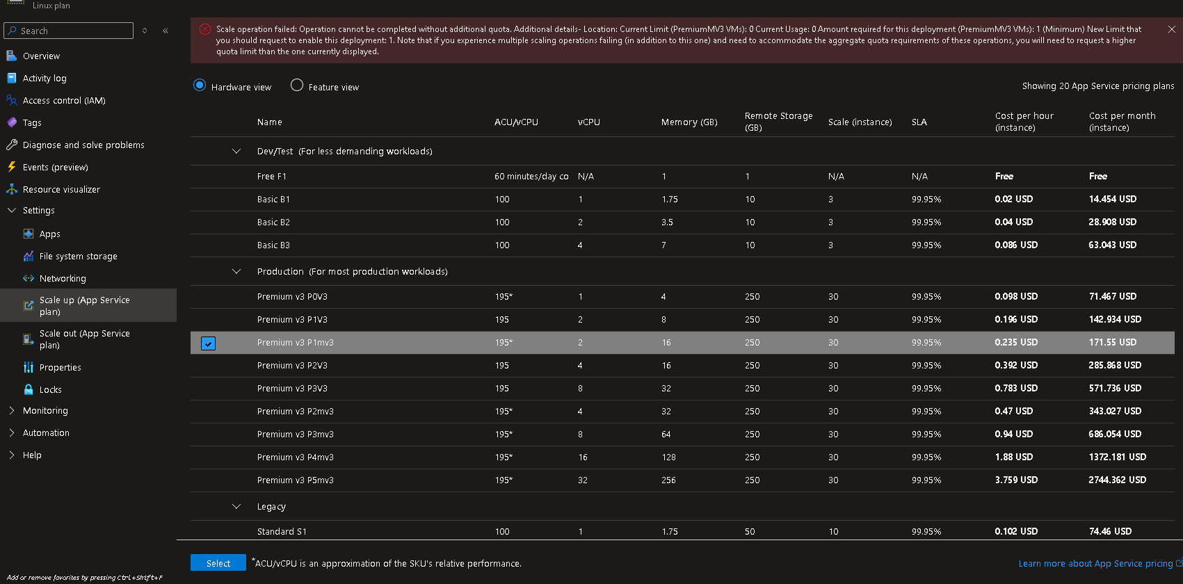

I have an Azure App plan in Switzerland North region, sized Premium v3 P1v3. After some load, we reached the memory limit, but CPU never really cross the 20%. So when I decided to scale up, I went for Premium v3 P1mv3 sku. When I try to scale to Premium v3 P1mv3, I get an error message, that I need to increase quota for that, however I can easily upscale to Premium v3 P2v3, also none of our quota limits are reached in that subscription.
Why is it not possible to use that sku, since it's offered?

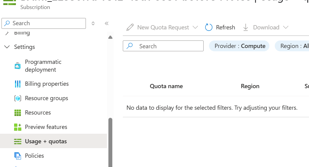

    To verify your quotas and request, see https://learn.microsoft.com/en-us/azure/quotas/view-quotas
    Request a quota increase in the Azure portal. https://learn.microsoft.com/en-us/azure/quotas/quickstart-increase-quota-portal
    If your subscription doesn’t currently support Premium v3 P1mv3 SKUs in the desired region, you can request a quota increase in the Usage + quotas section, select Request increase.

    Thanks for the detail, the error means the selected SKU (like P1mv3) requires a quota increase in that region.

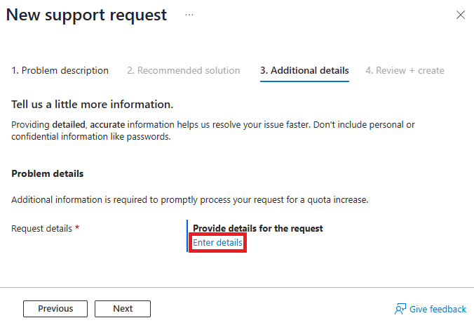

    you can give a request from the below screen, you will find it under your subscription or from the below steps.
    You can use instructions below to request an increase PremiumV3 limit.
    Please carefully follow instructions below to create a new Service and subscription limits (quotas) request to increase quota for App Services.
    1. Navigate to this link to start the process:
    https://portal.azure.com/#view/Microsoft_Azure_Support/HelpAndSupportBlade/~/overview
    2. Click Create a support request button at top
    3. If you see Support AI Assistant as shown below, click Switch to old experience button on right. Otherwise, proceed to step #4
    4. Enter quota in the box and click Go
    5. Select Others / Service and subscription limits (quotas) and click Next
    6. Click Create a support request button, as shown
    7. Select Issue type: Service and subscription limits (quotas), Subscription: <subscription that needs quota increase>, Quota type: Web App (Windows and Linux), click Next
    8. On Additional details tab, click Enter details, fill out Quota details for Region / App Service plan / New VM limit requested on the flyout window, and click Save and continue
    9. Finish filling out Additional details tab, click Next, review and click Create. You should receive an automated email within a few minutes.
