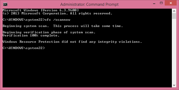

    Perform SFC(System File Checker) scan and see if it helps.

    2014-01-31T21:37:36+00:00
    I performed that and I received the following message
    but problem still exist. When I open some folders, CPU usage of COM Surrogate is getting higher (about 15%-20%). By the way, I didn't receive any crashing message. I set up windows again yesterday but this issue didn't change.
