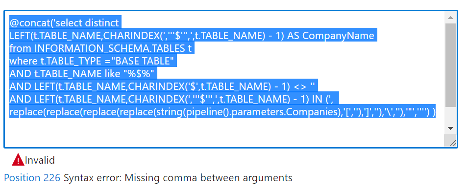

    Sorry for repeating Please don't remove the where clause statment.I am sending you the whole script once again :
    @markus.bohland@hotmail.de ('select distinct
    LEFT(t.TABLE_NAME,CHARINDEX(','''$''',',t.TABLE_NAME) - 1) AS CompanyName
    from INFORMATION_SCHEMA.TABLES t
    where t.TABLE_TYPE ="BASE TABLE"
    AND t.TABLE_NAME like "%$%"
    AND LEFT(t.TABLE_NAME,CHARINDEX('$',t.TABLE_NAME) - 1) <> ''
    AND LEFT(t.TABLE_NAME,CHARINDEX(','''$''',',t.TABLE_NAME) - 1) IN (', replace(replace(replace(replace(string(pipeline().parameters.Companies),'[',''),']',''),'\',''),'"','''') )
    I am getting error

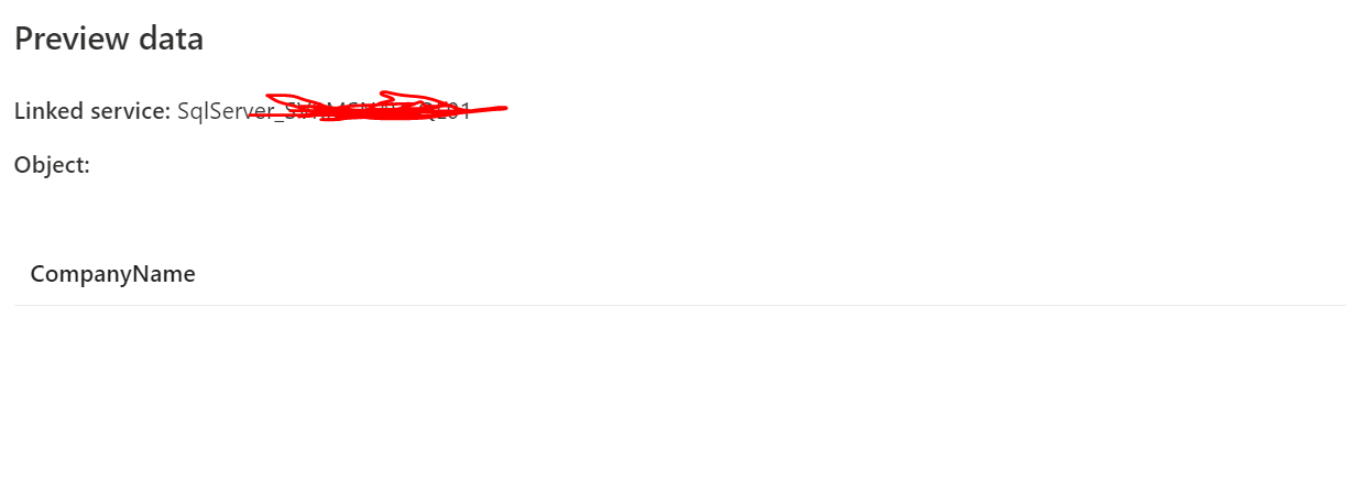

    The query is working fine Now the out put is blank.Please refer the screenshot below:
    Passing paramter in Pipeline :
    I have Passed the value in parameter :
    The output is blank

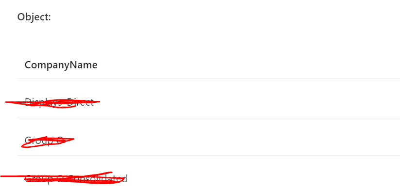

    When i run the query it is showing blank.If i comment this "AND LEFT(t.TABLE_NAME,CHARINDEX(','''$''',',t.TABLE_NAME) - 1) IN (', replace(replace(replace(replace(string(pipeline().parameters.Companies),'[',''),']',''),'\',''),'"','''') )"
    If i run the previous query
    select DISTINCT LEFT(t.TABLE_NAME,CHARINDEX('$',t.TABLE_NAME) - 1) AS CompanyName
    where t.TABLE_TYPE = 'BASE TABLE'
    AND t.TABLE_NAME like '%$%'
    Then the output will be
