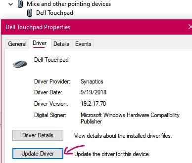

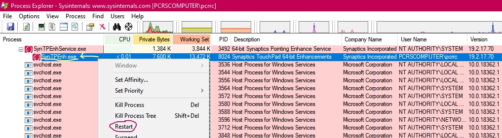

    Now I recall I had symptoms similar to yours in the earliest version of Win 10. The mouse (actually the touchpad) would become erratic & within minutes the whole computer would freeze. A reboot before the freeze would get the touchpad working again. Otherwise I had to do a hard shutdown. Reinstalling the Dell touchpad drivers was not a cure, except for the reboot involved.
    Eventually, I discovered a simple restart of SynTPEnh.exe would work just as well as a reboot. But Task Manager won't do that. You need Process Explorer...
    https://docs.microsoft.com/en-us/sysinternals/downloads/process-explorer
    Process Explorer v.16.30    (Hmmm - mine was only 16.21)
    Ultimately, a driver update came in & was a permanent cure. Try clicking for one in Device Manager (search automatically). If that fails, go to the computer's site & check for an update there.
