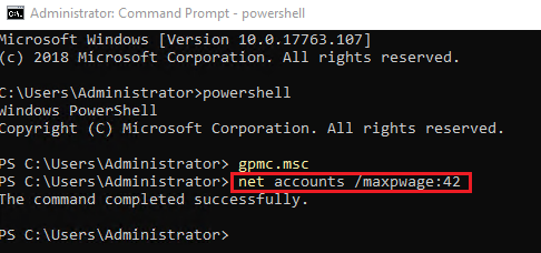

    2021-04-27T09:18:14.4+00:00
    Hi Barry,
    Would you try another powershell code? It should help you change the policy directly on your core server:
    For your reference:

    2021-04-28T02:53:44.703+00:00
    Hi Barry,
    Thanks for your information. If you have any other problem, please feel free to feedback; if you don’t, please help accept the answer.
