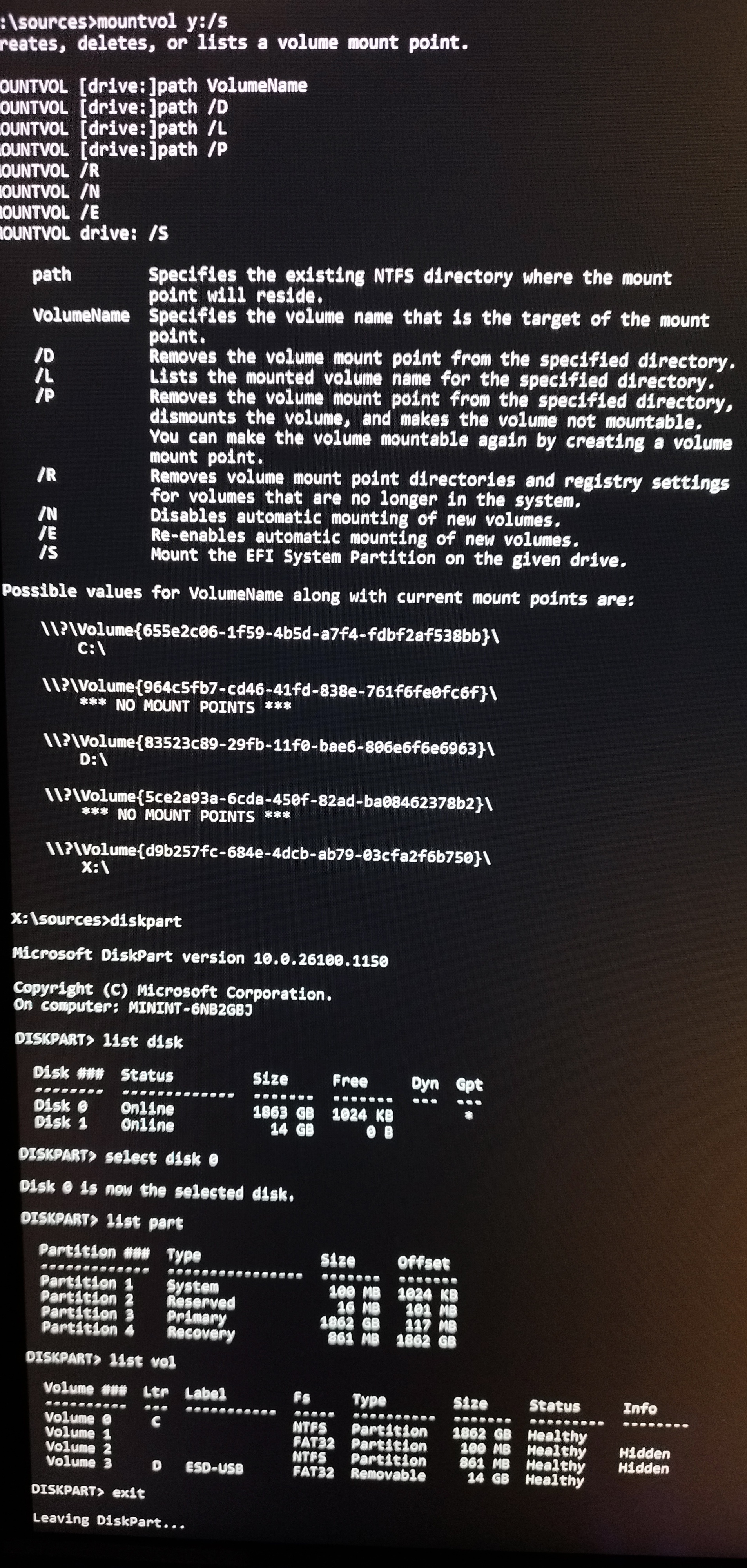

    Please boot into WinRE and open Command Prompt in WinRE. In WinRE Command Prompt, run these commands:
    mountvol y: /s
    diskpart
    list disk
    select disk 0
    list part
    list vol
    exit
    Using your mobile phone or camera, take photos of the output screen and share the images here. Don't quit WinRE yet. Two more commands need to be run.

    2025-05-05T20:59:27+00:00
    I ended up using the boot drive, this is what it came up with
