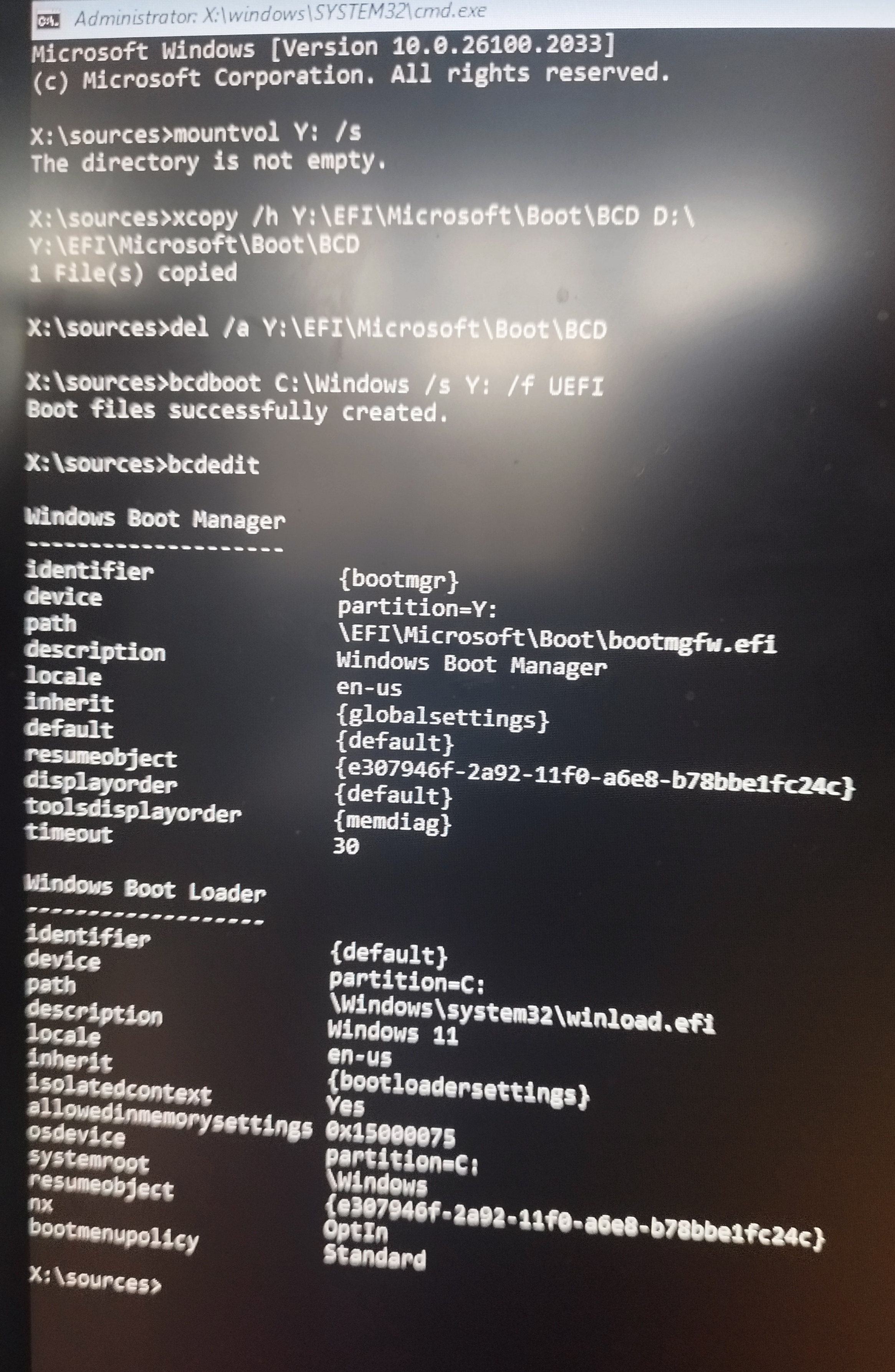

  1. Ramesh Srinivasan 173.4K Reputation points Volunteer Moderator
    2025-05-06T15:07:44+00:00
    The commands ran correctly. The old BCD has been backed up.
    Please restart the system. Test signing is now turned off (default setting).

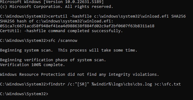

    2025-05-06T02:48:35+00:00
    After booting into Windows, run these commands from the admin Command Prompt.
    certutil -hashfile c:\windows\system32\winload.efi SHA256
    sfc /scannow
    findstr /c:"[SR]" %windir%\logs\cbs\cbs.log >c:\sfc.txt
    Post the output of the 1st command.
    Share c:\sfc.txt.

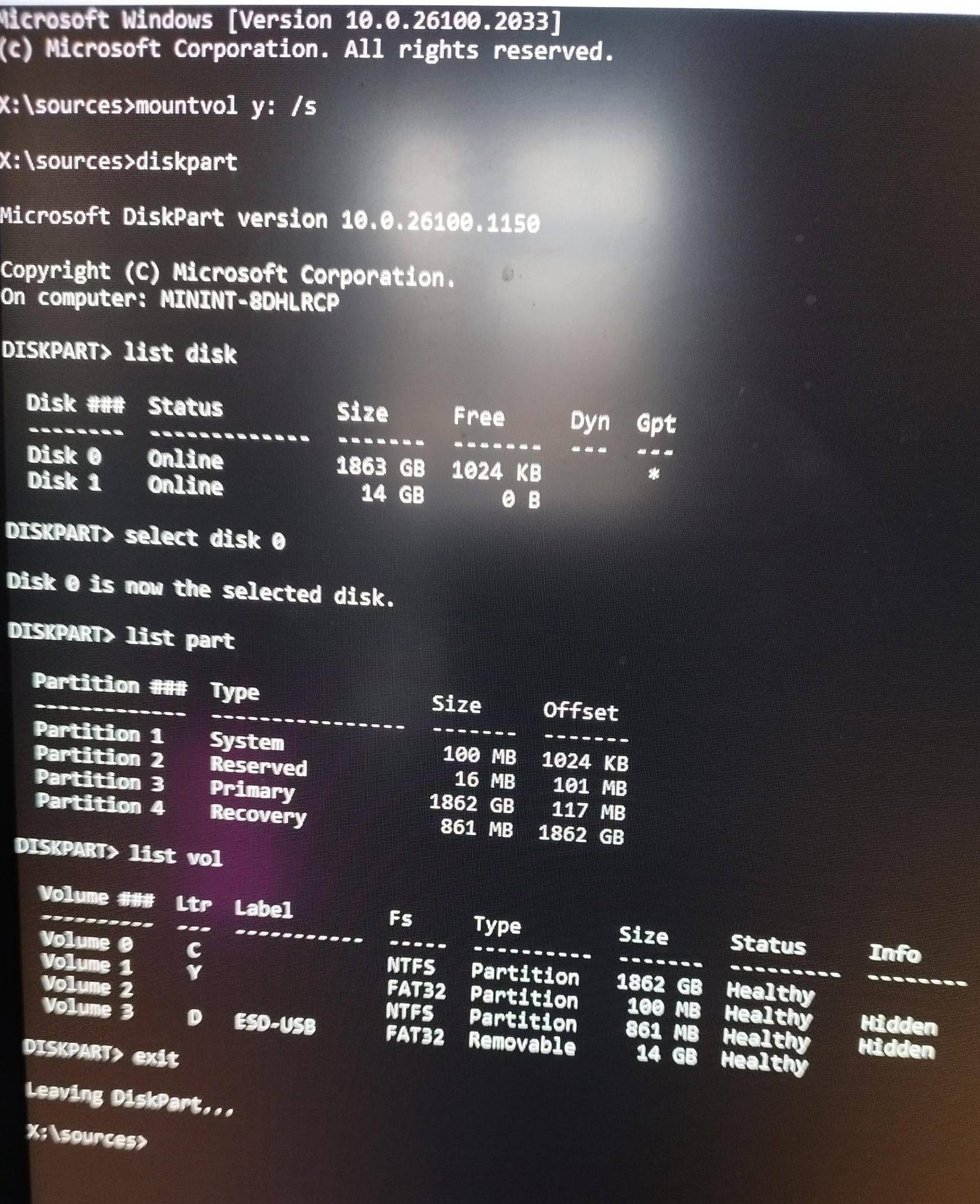

    Regarding your WinRE output
    The 1st command you typed is incorrect. You removed a space.
    Please rerun everything and post the output.
    (or)
    Run:
    diskpart
    select disk 0
    select part 1
    assign letter=Y
    list vol
    exit
    2025-05-06T15:02:46+00:00
    Here is the output
    2025-05-06T06:41:02+00:00
    Sorry about that, here is the winre commands again
    Here is the sfc.txt
    And here is the output of the other commands given
  4. Ramesh Srinivasan 173.4K Reputation points Volunteer Moderator
    2025-05-06T06:51:47+00:00
    SFC ran fine, and no corrupted files.

    If so, run:
    • mountvol Y: /s
    • *xcopy /h Y:\EFI\Microsoft\Boot\BCD D:*
    • del /a Y:\EFI\Microsoft\Boot\BCD
    • bcdboot  C:\Windows /s Y: /f UEFI
    • bcdedit
    Post the output.
    It resets the BCD to default settings.
    Restart the computer.
