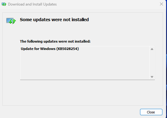

    2023-07 Cumulative Update Preview for Windows 11 Version 22H2 for x64-based Systems (KB5028254) windows11.0-kb5028254-x64_d39314973f404fca4cc205e6c2fc848fea4c25ed.msu
    When I try to download the update through Windows Update I get error code 0x80248007, and when I tried to download with the standalone client it also failed.

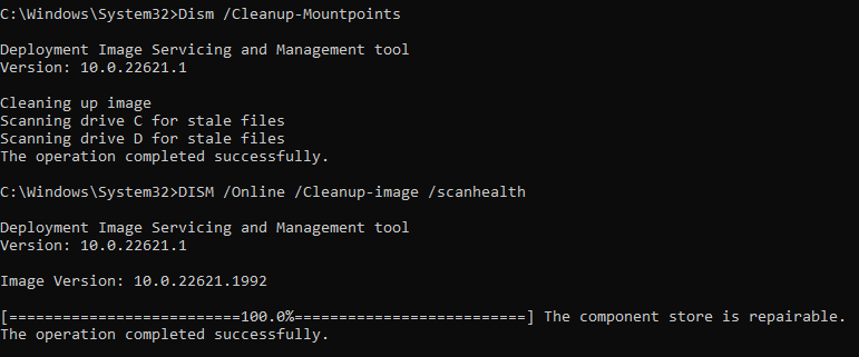

    Also I ran DISM /cleanup-mountpoints and used DISM /Online /cleanup-image /scanhealth after and it returned with Component Store is repairable. Not sure if this is useful but I thought I would write a reply. (DISM /online /cleanup-image /restorehealth still failed)Image
