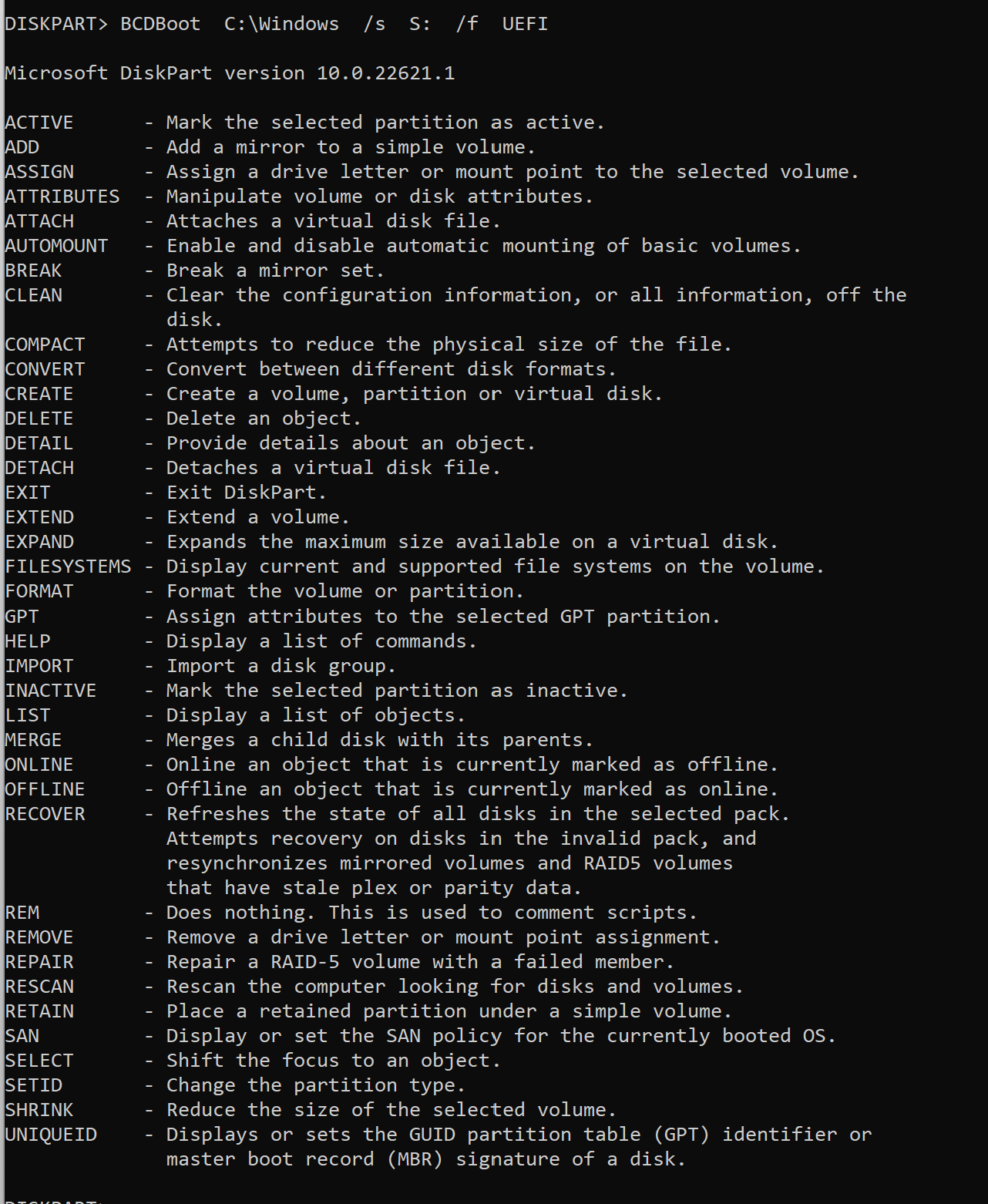

    2023-04-21T12:32:05+00:00
    This command doesnt seem to be working?
    2023-04-21T13:38:46+00:00
    Just so you can continue, you need to exit diskpart first, so just type exit.
    2023-04-21T17:10:13+00:00
    Just as Saltgrass said, type Exit to exit DiskPart. Then enter that BCDBoot command.
