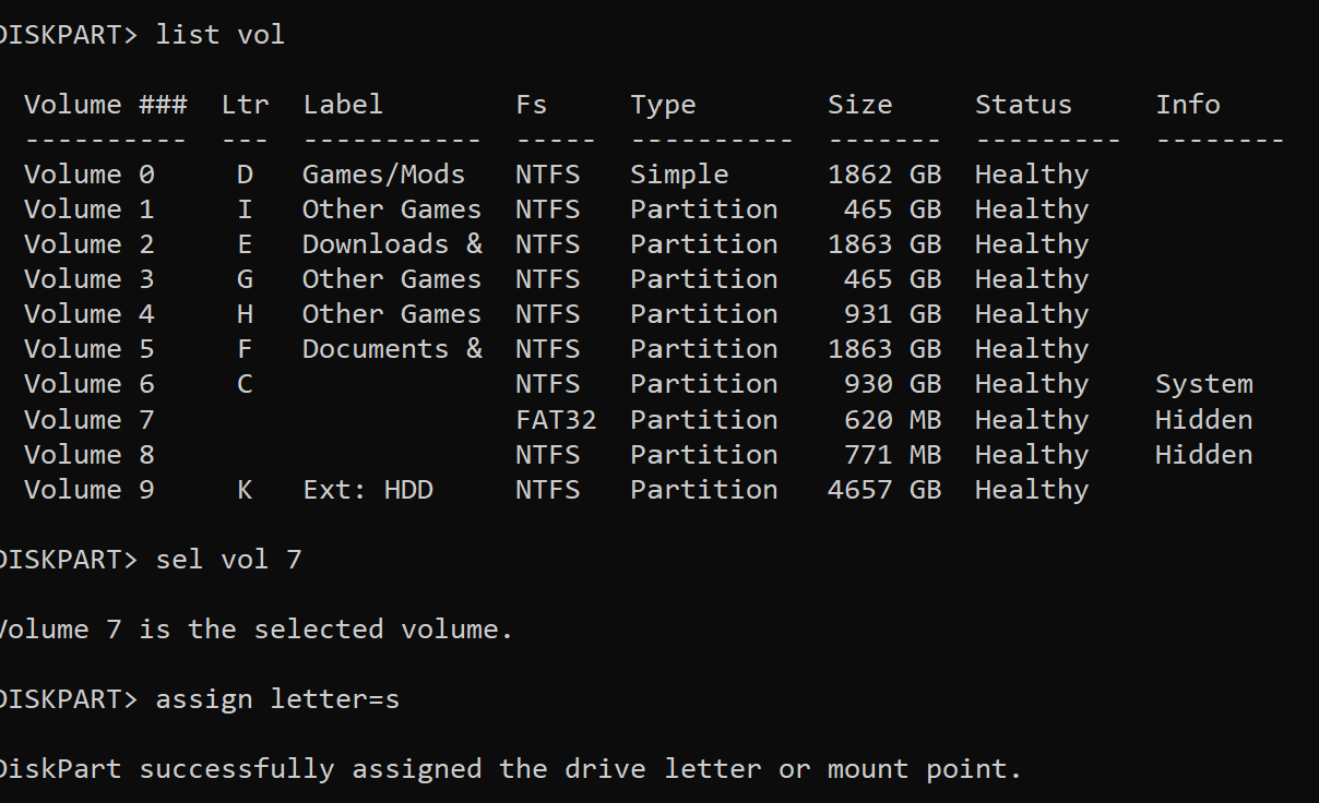

    (1) You've got two System partitions each with its own BCD. C partition is doubling as a System partition, & EFI is a System partition...
    That is likely what is confusing ReagentC. It needs to find the BCD in order to enable the Recovery partition. We need to tell Windows that EFI is to be used -- not C. Let's try this...
    DiskPart<<<Enter DiskPart
    List  Vol<<<List the volumes & letters
    Select  Vol  7           <<<Select EFI -- I guess it's still Volume 7
    Assign  Letter=S     <<<Give it letter S -- unless List Vol shows it's already there
    Exit<<<Exit Diskpart
    BCDBoot  C:\Windows  /s  S:  /f  UEFI <<< **** Rebuild the BCD in EFI & all other boot files.
    A reboot will be necessary to inform the rest of Windows of the change.

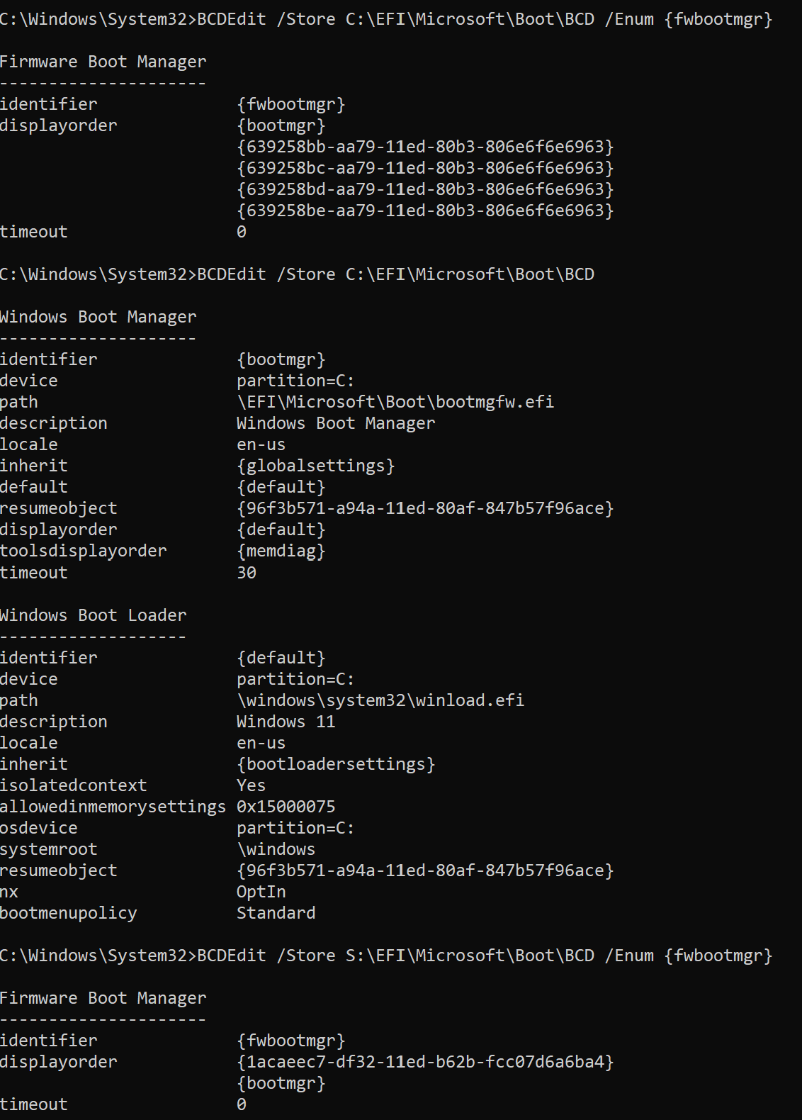

    Does BCDEdit /Enum {fwbootmgr} now show {bootmgr} on top?
    Does BCDEdit /Enum {Bootmgr} name either HarddiskVolume9 or S: as the Device?

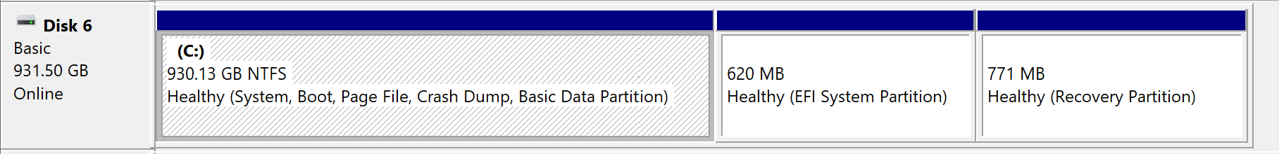

    Looking at your prior listings, I now think the 8th partition down will be C. And EFI will be partition 9. Disks 0-5 will have 1 partition each, then Disk 6 shows...

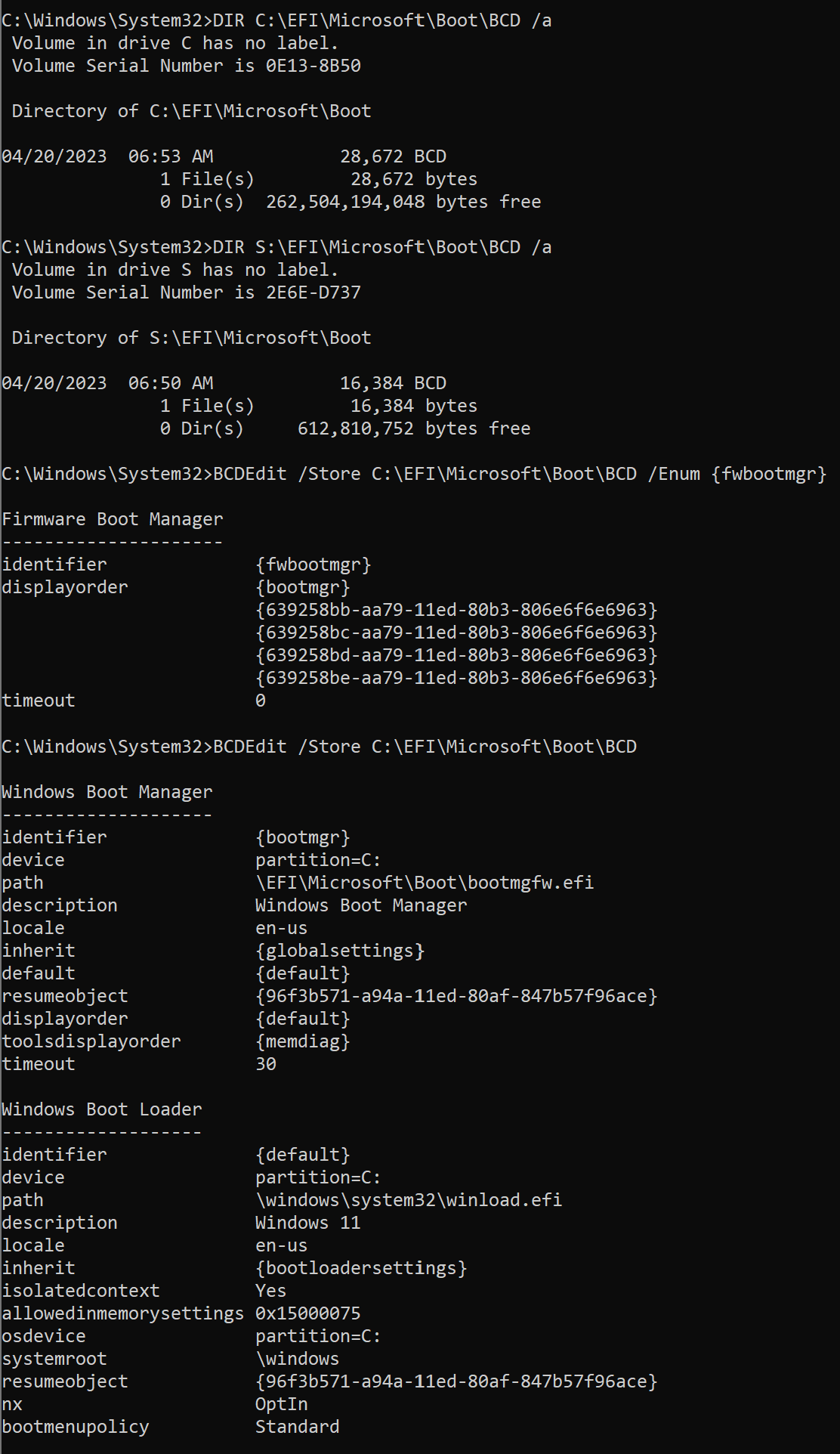

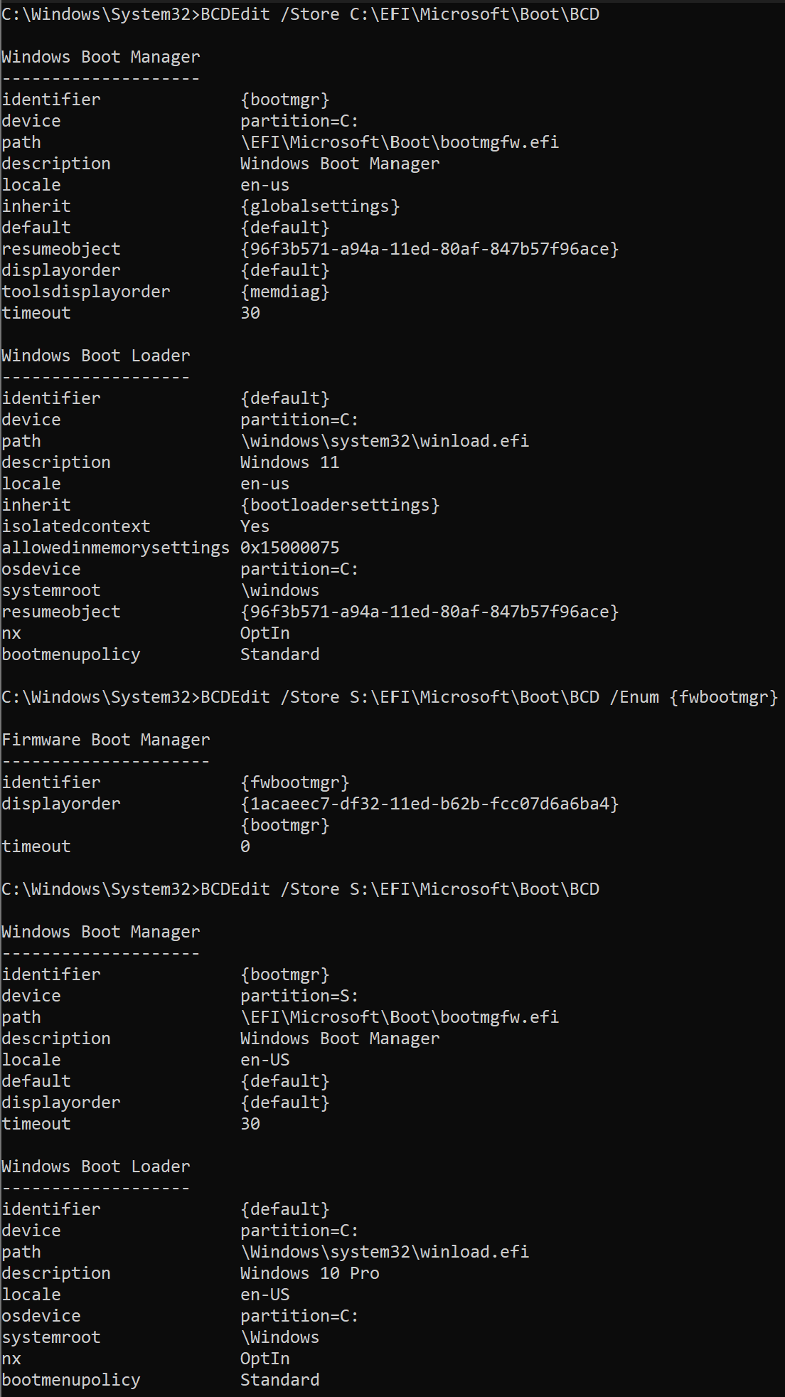

    So -- HarddiskVolume8 is the Windows partition. (EFI is HarddiskVolume9). Yep, the BCD that is on C (shown with /Store) shows the letter...
    The one that is on EFI (S:) shows...
    We want the one on EFI (S:) to be the only one. Windows gets confused when there is more than one System partition.

    I'll try my best, Ramesh. Thanks for the confidence in me. I think we've got to get rid of that System attribute that is on C. And the BCD that is there must go too. Definitely, have a safe trip.
