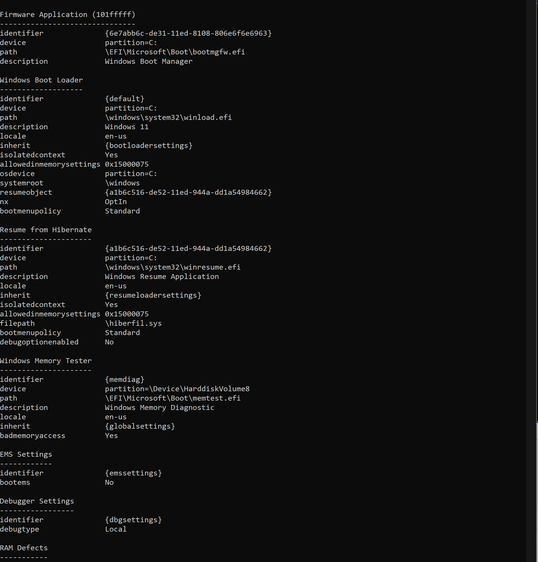

    Looking at your prior listings, I now think the 8th partition down will be C. And EFI will be partition 9. Disks 0-5 will have 1 partition each, then Disk 6 shows...
    So -- HarddiskVolume8 is the Windows partition. (EFI is HarddiskVolume9). Yep, the BCD that is on C (shown with /Store) shows the letter...
    The one that is on EFI (S:) shows...
    We want the one on EFI (S:) to be the only one. Windows gets confused when there is more than one System partition.

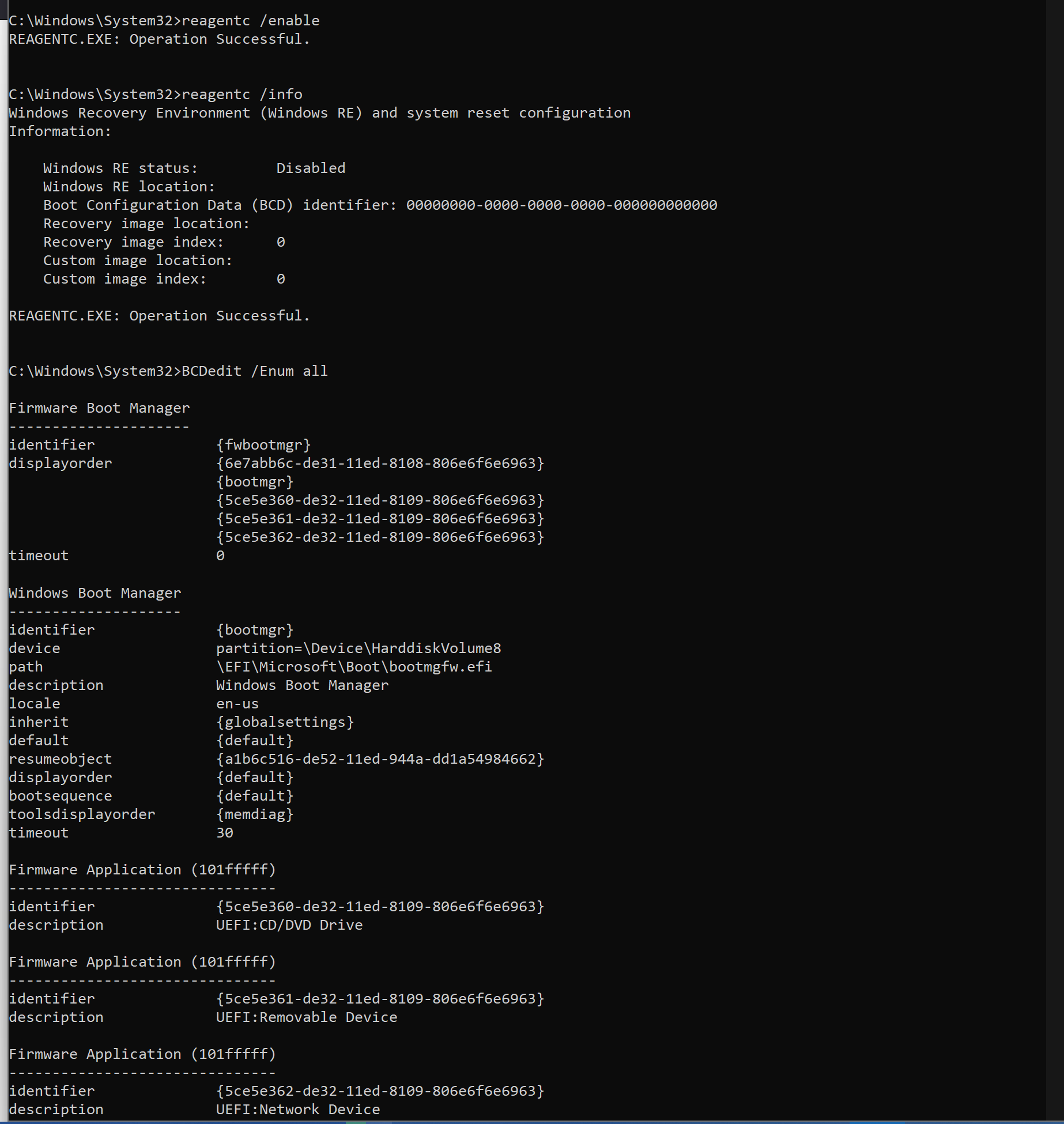

  1. Ramesh Srinivasan 173.8K Reputation points Volunteer Moderator
    2023-04-19T17:42:59+00:00
    Ok. Thanks.
    Type exit to quit the Diskpart environment.
    Run:
    • reagentc /enable
    • reagentc /info
    If Reagentc can't update the BCD, let's clean boot Windows and try again.

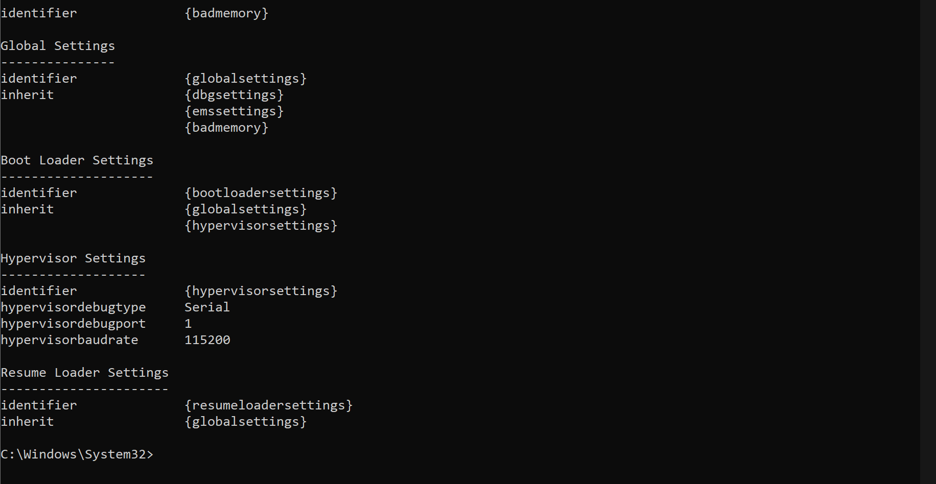

    Edit:
    To see if the BCD store can be enumerated, run:
    • BCDedit /Enum all
    2023-04-19T17:47:39+00:00
    I know a dynamic partition on a drive will hurt a UEFI system. I do not know if an entire drive would cause the same type of problems.
    2023-04-19T18:07:24+00:00
    I will have to attempt a clean boot later today. I am currently remoted into my PC and I'm not sure if I could connect with a clean boot.
  4. Ramesh Srinivasan 173.8K Reputation points Volunteer Moderator
    2023-04-19T18:11:25+00:00
    Hi Lumince,
    No clean boot is required now, as the BCD error no longer appears.
    Please upload "C:\Windows\Logs\ReAgent\ReAgent.log" instead.
    I think the commands need to be retried without changing the sequence. Changing the sequence causes ReAgentC /enable command to rely on a drive-letter.
