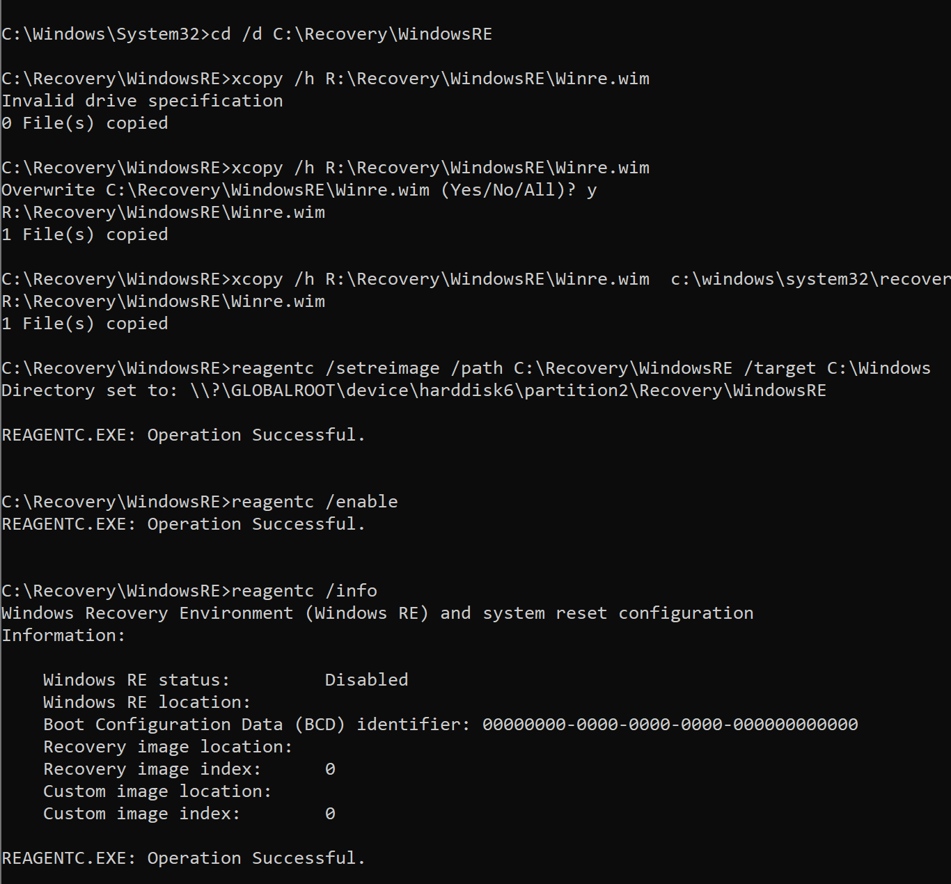

    I attempted to rerun the commands again and it still did not enable. Here is the log https://gofile.io/d/Xgl4BP

    Please try this workaround:
    • diskpart
    • sel vol 8
    • assign letter=r
    • exit
    • md C:\Recovery\WindowsRE
    • cd /d C:\Recovery\WindowsRE
    • xcopy /h R:\Recovery\WindowsRE\Winre.wim
    • xcopy /h R:\Recovery\WindowsRE\Winre.wim c:\windows\system32\recovery\
    • reagentc /setreimage /path C:\Recovery\WindowsRE /target C:\Windows
    • reagentc /enable
    • reagentc /info
    Edit: Added the assign letter command in diskpart.
    2023-04-19T18:51:09+00:00
    Didnt work :( I might just have to live without Windows RE?...
